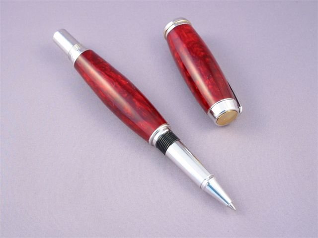

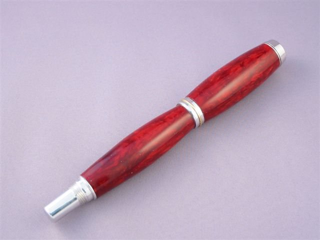

Hi,
I tried one of these today, a bowling ball blank on a Junior Gent. I had problems with pin holes in the material and I am still not sure if I was able to fill them all as I tried to use Mylands Sealer to do so.
Any thoughts on methods for sealing this material are welcome.
Jim, if this is anything like the balls that some of us cut up, then what Travis said. But I add a little turning dust (not shavings) to it. BTW, nice looking pen!
I would spin em back up on the lathe and start to sand with some 400 grit, then carefully drop some thin ca in the areas where the holes appear. They should fill with dust and glue. MM up through 12000, slap in some Hut Plastic Polish, then off to buffing wheel with some white diamond, and I'll be they will be camoflauged.....
P.S. The coloring looks great, especially on the chrome colored kit.
