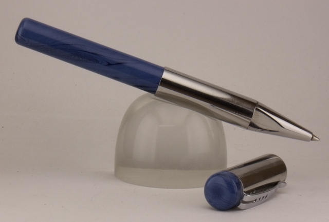

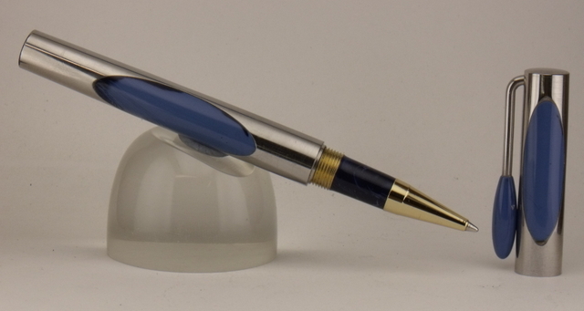

These two pens were made with real cut up bowling ball resin blanks.
You can compare how much they have faded by being under 'daylight' lights in a display case. The remaining green bowling ball blanks haven't been out of my shop so haven't faded.
On the pen with the ellipse shapes, the cap was always displayed with it on, hence no fade.
The first one is my Bayonet Concept Pen and the other was called Five Ellipse pen where you can see how dark they were originally.
I'm not saying that ANY other bowling ball blank WILL do this but be warned that it might.:wink:
