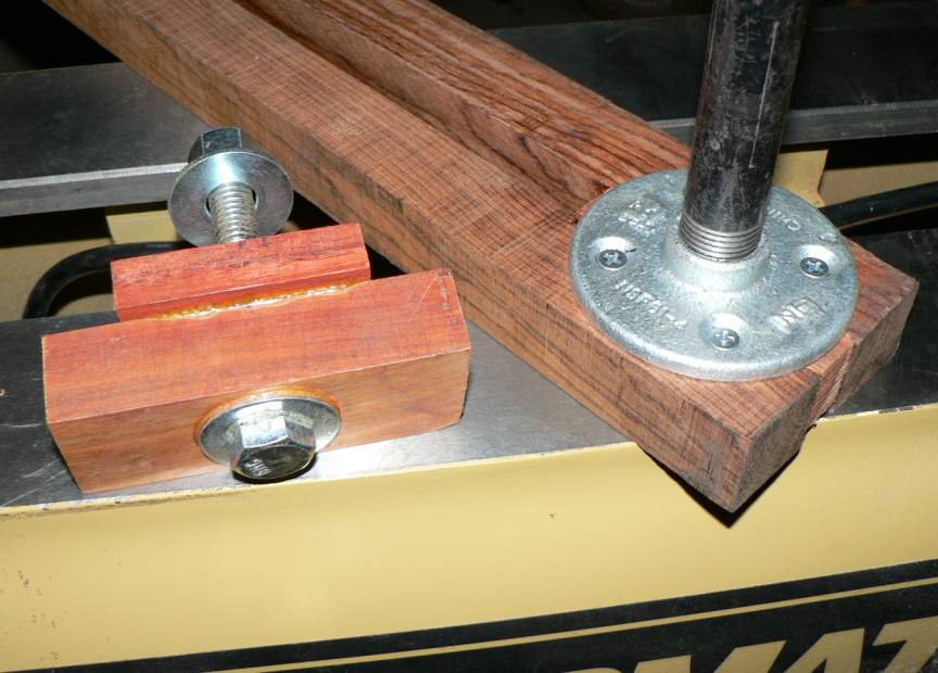

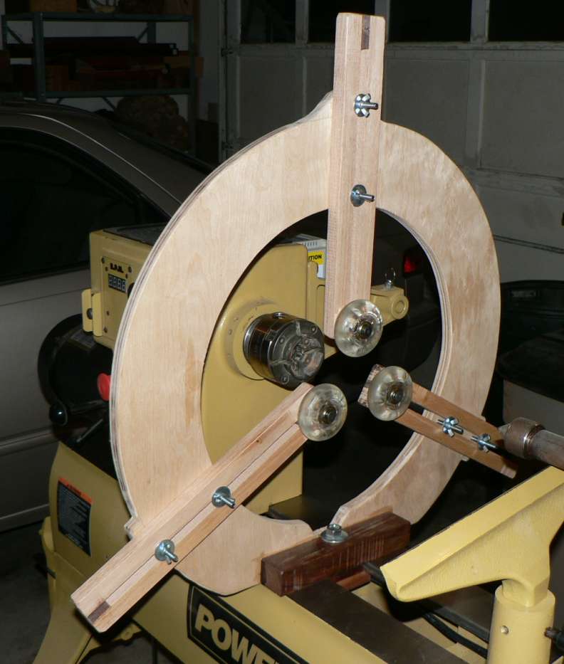

Here is my completed bowl steady and spindle/vase steady. They share one bed lock.
I know the bowl steady pics have been posted earlier but these go together :D.
The spindle steady can be used in making really BIG pens...up to 14 inches in diameter :D[}:)]

Jim,

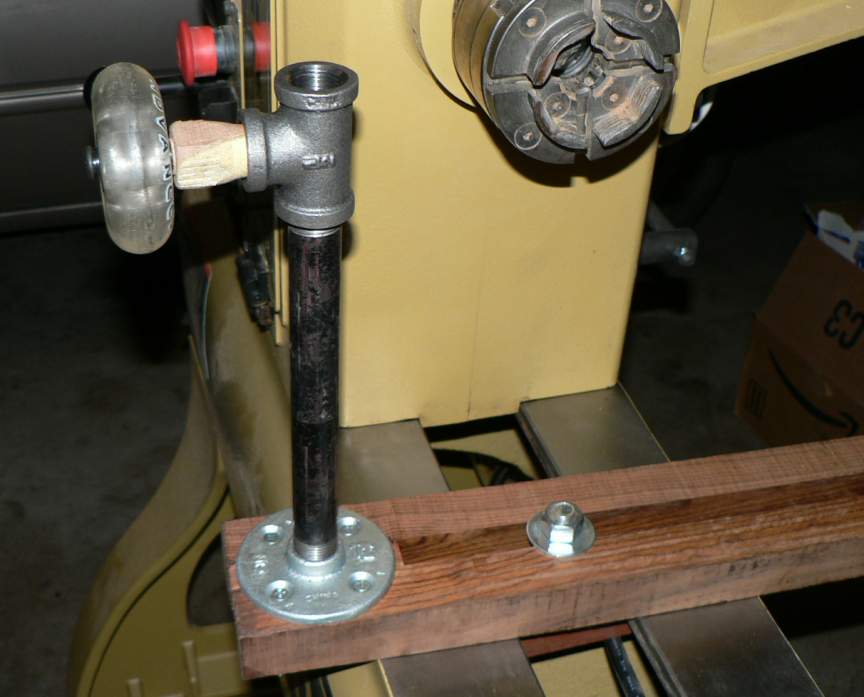

The bowl steady is actually more for platters. When you turn thin, big diameter plate/platter, they tend to flex. By having the bowl steady on the back near where you are cutting (pushing in a way), it will provide counter pressure and stability.
Hope my explanation helps.

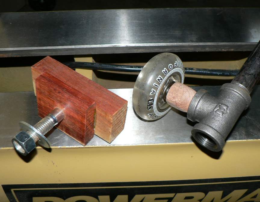

Dario, did you buy new for the wheels or scavage them from old blades? I am in the "gather mode" for this exact project. Been eyeballing used rollerblades on e-bay, seems like I might get a set from $10.00 to $20.00 shipped. (easier when you don't care about shoe size!)
Do you have a "hook" piece on the headstock side that slips under the ways or do you rely on the rear clamp only?

I scavenged my son's old inline skate wheels. I just used the wheel from one. If you have any Goodwill or Salvation Army store close by, check them. You can buy a pair with good set of wheels for under $2.00 [;)] I actually bought one pair for $1.00 and it is an original Rollerblade [:0].
My locking clamp is only as shown. I just slip it between the ways and in the steady....very easy. Once it is tightened, I cannot budge it one bit. I used really nice hard wood though, most are cocobolo, paela, and oak.
Yep, that's perfect! NOW I get it! I was having trouble envisioning how a wheel that was turning on the edge of the platter, or on the side facing the turner, would be of any advantage. As I'm sure you can see, I can be a little "slow" some times!

Dairo, have you thought about a redesign on the bolw steady so that you have 2 wheels to help center the bowl? I ahve a folder of saved photos of both designs and most all the bolw steadys I see have the 2 wheels in a "Y" shape. The best style looks like a set of bowl thickness gauges with a spring on the back side to pull the wheels in when the bowl gets smaller.

I thought of doing it with 2 wheels but decided on one. Much simpler too. Make sure that the "Y" will pivot freely if you do that so both wheels will adjust properly and be in contact with uniform pressure on the piece.
Re: Goodwill, another option is buy new replacement wheels (I saw some there before too). Your original budget of $20.00 should be sufficient if you find them on sale at sporting goods stores.

Thanks, my wife did not find any the other day when she looked, but I do have a bid on e-bay for a pair. Under $10 shipped if I win without up bidding. I am not in a hurry though so I can wait it out. I want to make the 3 wheel spindle steady with wheels & 3 extra arms that use just the bearings for close up work and a 2 wheels "Y" rest for bowls. That will leave me with just the 3 spare wheels if they are all good.
