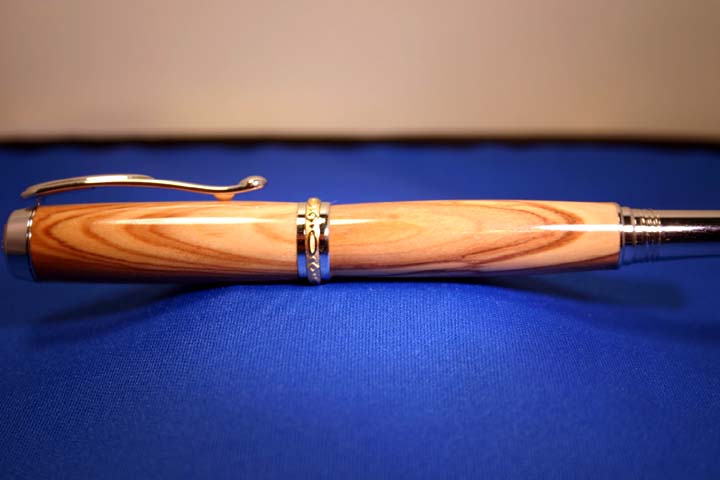

Haven't posted in a while. Been working on a finish for oily woods. Think I have it. Whata you guys think.

Comments welcome
Thanks
Randy

sanded with Micromesh then 3 coats of Bulls eye Seal coat using steel wool bewteen coats. Then 3 coats of minwax no sanding bewteen coats. help that helps
Thanks
Randy
