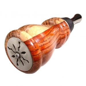

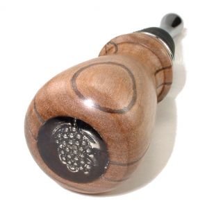

If you don't like the dimple at the top, you have several options:
1) Cut the blank longer than you want the finished stopper to be and turn away the dimple after you've turned most of the shape of the rest of the stopper
2) Mount a cabochon. Again, after turning the primary shape, cut a hole (with a drill or gouges) the size of the inset you want to mount and then glue in your cabochon after finishing the rest of the stopper. Here are a few examples:
