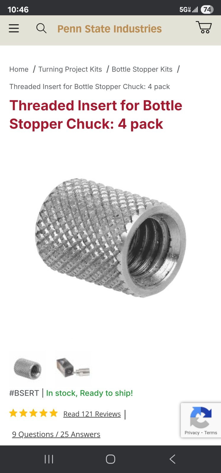

I've always had better luck using the threaded knurls that mount inside the blank. Stronger hold on the mandrel also.
Ya, the only thing I don't like about the lowes insert is making sure you have the perfect hole to thread and not too tight to crack the wood.

The ID threads on the inserts are right handed. The outer threads are also right handed although they are very coarse threads.
The inserts @bsshog40 has are supposed to be press fitted into the hole and then the ID threads are right handed.
Tap= threaded part on mandrel with notch to cut threads and clear debris.
The inserts I have used in the past thread into wood left handed so they don't back out when removing a RH screw or bolt. I don't anticipate buying press fits from Amazon in the near future although I do have a shopping list if I decide to go thtt route.

I agree with everyone above, the threaded inserts are the way to go here. I pretty much only use Niles bottle stoppers so I use their inserts typically too. Carl Jacobson has a video with his method to drill and face stoppers that he uses. (essentially use a forstner bit to get a flat face for turning and then drill the hole) I use the lathe to seat the insert the same as him and it makes a pretty foolproof method to have things squared up.
I epoxy the inserts in.
Thanks.
Prior to the threaded inserts (like are sold at Niles or Penn State0, I would put the blank in the lathe, use a Forster bit to make an initial cut (don't know the exact size right now) but one that would allow a tight fit for a 3/8 inch stainless steel nut, and then drilled a 3/8 in hole around 3/4 of an inch deep. After that I would epoxy the 3/8 inch stainless steel nut into the Forster cut out (which has a flat bottom) and be good to go. I did that on hundreds of stoppers and never had a problem. This being said, the threaded inserts are easier.
