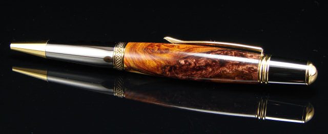

I have done a lot of pen blanks and even some bowl blanks with resin to fill cracks. I use Alumilite but I woudl guess PR would work also. I make a mold out of cardboard and tape that is a little bigger and deeper than the piece I am trying to fix. I then pour resin in to completely submerge the piece and put it in my pressure pot. I pressurize to 70 psi and let it cure. It gets 100% of the larger cracks and voids and about 95% of the smallest. I plan to write up a little something one of these days. Here is a pen I made with this process. The copper colored swirl towards the right is the resin filled void/crack. If you need more detailed help, shoot me a pm or give me a call. My number is 512-738-0775.
