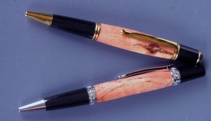

This is the wood you need to identify. It comes from my farm in Columbus, TX and these two pens were made from this mystery wood.
The image in Post #2 is in my IAP Photo Album.
If you haven't already, you can click on the image to open the photo link in my album and click on that image to open a large, hi-res image where you can see the grain structure and coloration a little more clearly.

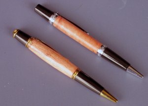

Here's a slightly different view of the 2 pens made from the mystery wood.
I had a slight chip-out on the bottom one when I got close to final diameter.
This is a hardwood species, but it cut like butter.

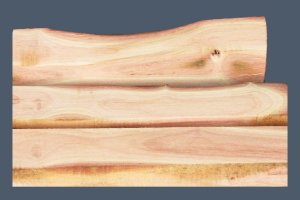

I cut a number of blanks and sanded a few of them slightly so the coloration & grain would be more visible. Here's a photo with a couple more of the blanks for your consideration.

Here is another picture of the two pens. I purposely selected a blank for the top pen with a rather large void because I wanted to see if I could fill it and have the blank hold together without stabilizing this blank. The hole in the void went all the way through to the tube. I drizzled a little thin CA, stuffed it with shavings, drizzled a little more thin CA, and rubbed on a little more shavings. Spritzed it with accelerator, let it set a few seconds, then turned the blank. I was quite pleased with how well it held up.
