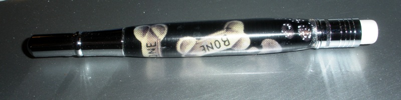

It isn't anything to rival caliber of work on this sight. But for me, at this time, it is the only thing I've been able to do for awhile. I glued the material to tube then cast in acrylic. The trick is getting the edges of the material to match on the "ends" of the cloth.
Comments welcome.

I browse the cotton cloth aisles at the fabric stores for things with a nice small print that will work on a small "canvas."
Cut materials to size.
Paint back of cloth piece with "decopage" glue
Glue it on tube and let dry
Put another coat of decopage glue over cloth to seal it before casting in PR
I have used polyester as well.
