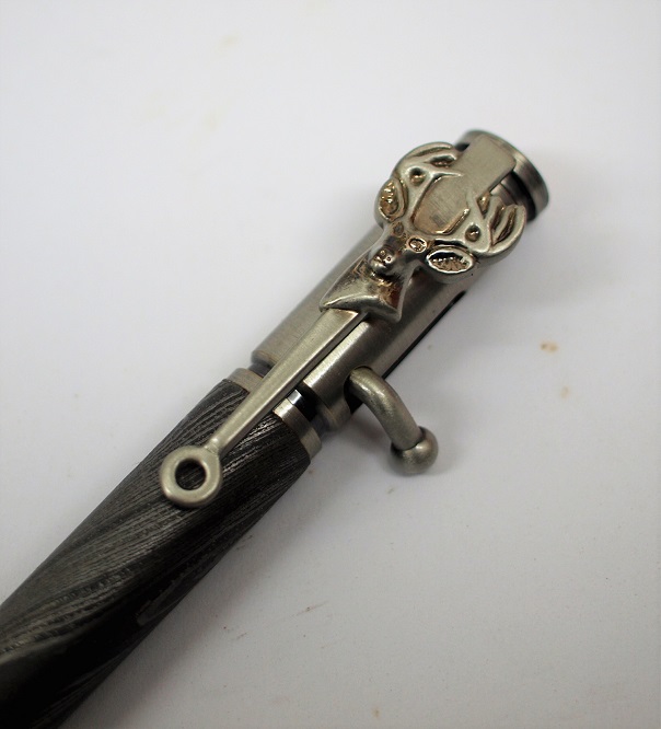

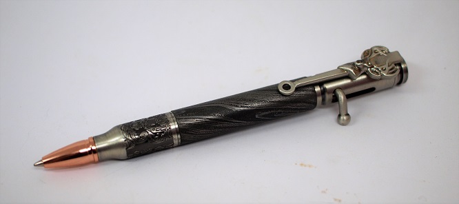

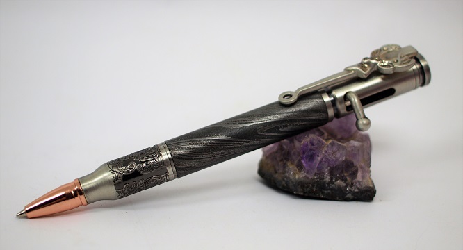

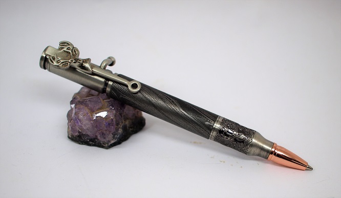

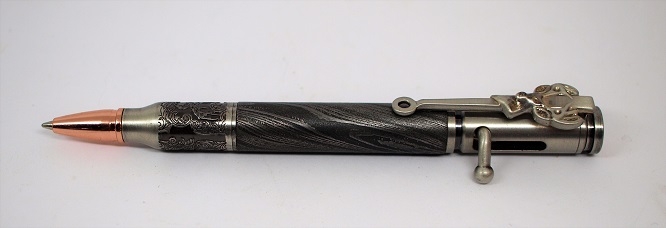

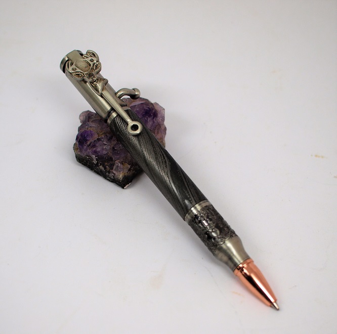

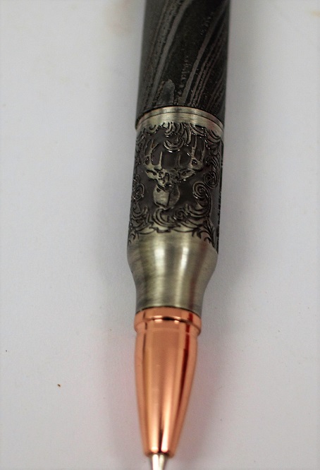

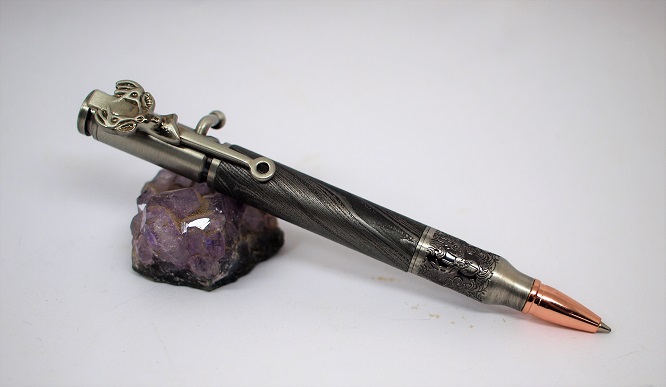

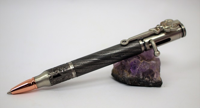

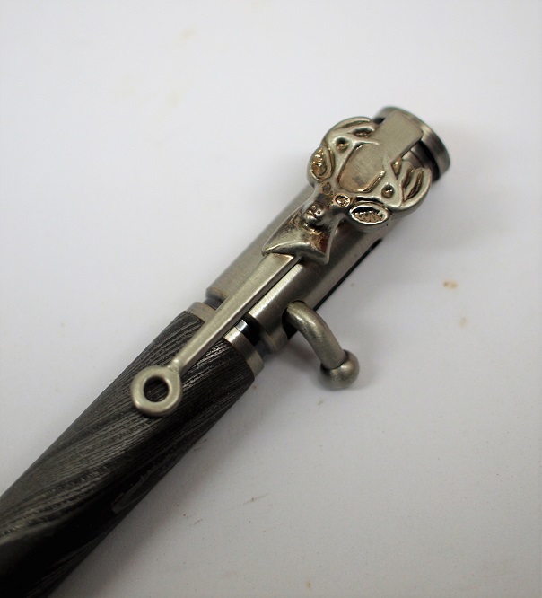

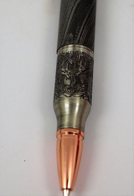

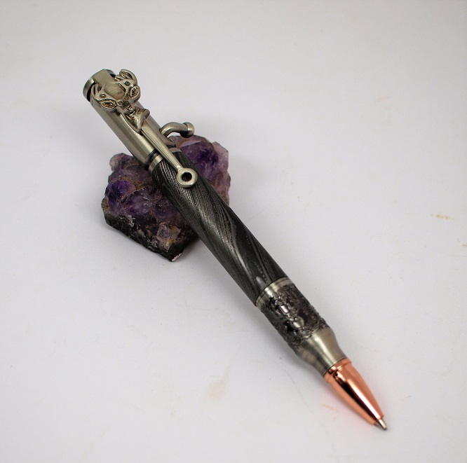

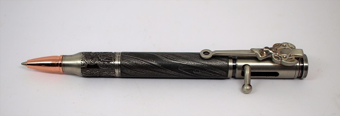

tjd Member Joined Jun 16, 2013 Messages 339 Location Carmarthenshire , Wales Mar 12, 2018 #1 A Deer Hunter in pewter from PSI. Made using real Damascus Steel. To create this effect the Steel was turned then soaked in Ferric Chloride and neutrilised in Sodium Bicarbonate before being polished on the mandrel. Last edited: Mar 12, 2018
MRDucks2 Member Joined Jul 17, 2017 Messages 3,389 Location Bristow, IN Mar 12, 2018 #2 Looks good, great color combination. Sent from my iPhone using Penturners.org mobile app
PenPal Member Joined Nov 29, 2006 Messages 2,707 Location Canberra, A.C.T., Australia. Mar 12, 2018 #3 Every now and then an outstanding themed pen pops up to totally impress. This is one of them Johnny. Peter.
Jim15 Member Joined Dec 20, 2005 Messages 21,691 Location Hamilton, Ohio, USA. Mar 12, 2018 #4 That's a beauty.
OZturner Member Joined Aug 5, 2013 Messages 6,661 Location Sydney. NSW. Australia Mar 13, 2018 #5 Magnificent Pen Thomas, Outstanding Damascus Steel Blank, Beautifully Shaped and Fitted. Glorious Finish, that Compliments the Hardware Perfectly. Beautiful Work. Brian.
