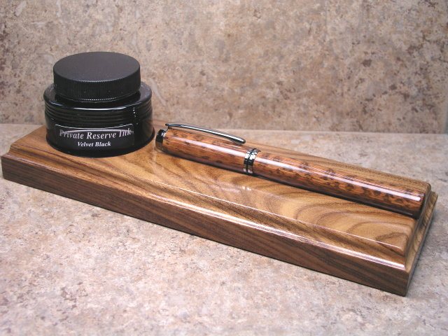

Many of you remember this Snakewood Baron foutain pen that I turned for my Sis's birthday. I bought some of the Private Reserve Ink from PenWorks and wanted to make a simple but functional desk set for it. The only dark wood I had around was Bolivian Rosewood, but I think the contrast is kinda nice.

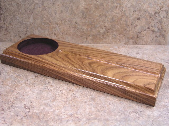

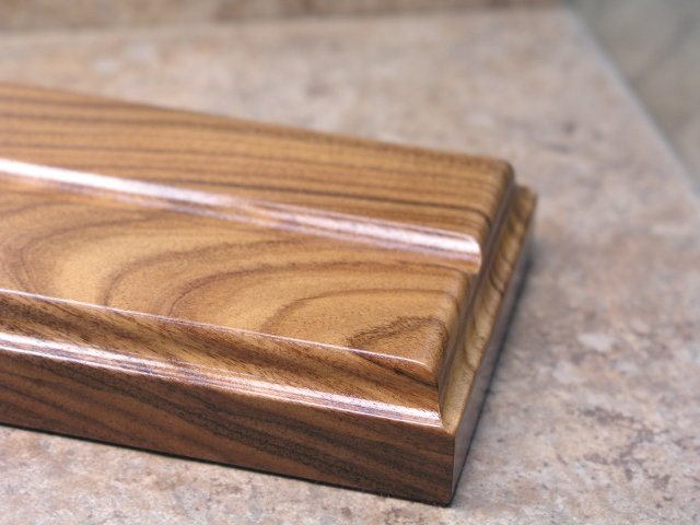

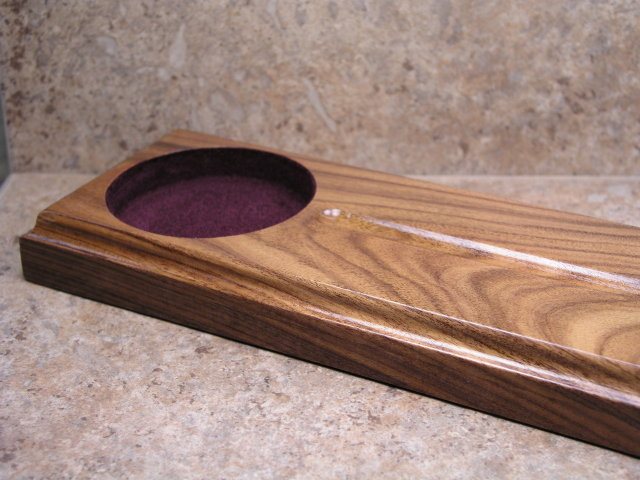

I am very fond of the Suede-Tex blow in flocking. I use it every chance I get. I this case it made for a nice contrast to the ink holder well (I also use it on the bottoms of all of my desk sets/stands). The ink bottle is oval on the bottom, but it still rests nicely in the circular hole. I did this one like a bandsaw box in that I trimmed away a 1/2" sheet off of the bottom of the base. I drilled the hole for the ink and glued to bottom back on. Glue joint is pretty well hidden in the nice grain on this piece. Some close ups give it away in some spots.
CA on the pen, Deft spray lacquer on the base.

BTW, what size router bit do you use to machine the groove for the pen?
Great job man!
Thanks Cav,
I used a 1/2" round over bit. The key in making the grooves for the pens though is to make some test passes on some scrap for depth. It allows you to address the angle at which the wall of the slot contact the pen.

Question for you? Why not use a forstner bit from the top and thereby not trim from the bottom and reglue? Would be interested in your design rationale on this exquisite piece. How can your sister not be impressed with it. I know that I am.
-Peter-[:)]
Thanks Peter,
To answer your question about the drilling...
Two reasons really. First the hole is 2 1/4" in diameter. I don't have a Forstner bit that large. I wanted to hole to be just about 1/16" larger than the bottle. So I used an adjustable drill press mounted circle cutter. Second, if using a forstner bit, you would have a divot in the bottom of the hole. Not a big deal really, but it was a condsideration for me. Also the circle cutters are so sharp that the finished hole needs almost no sanding (Lazy)...

<br />.....Question for you? Why not use a forstner bit from the top and thereby not trim from the bottom and reglue?
And along the same line.....
Since you are glueing up the base, why not make the hole oval to match the bottle profile?? It would not be hard to do with a scroll saw, jig saw or even manually with a coping saw? And don't give me that lazy crap....we all know that just isn't true!!
And as to the Forstner bit dimple thing, you could always fill it with a little wood putty or even chewing gum. With the flocking, no one would know that a fill had been made.
I see I have you fooled ! [:D]
The oval cut out would work well too. To be honest, I made the hole a little more universal just in case she ever decides to go with a different ink bottle. But the scroll saw was an idea I considered.
