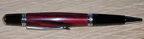

I finally got my order for Bois de Rose in and here is a pic of my first pen with it. It is my 10th pen altogether. I scratched it up a bit, while trying to remove a pen mill burr, but otherwise, it isn't bad. I had a lot of trouble with my CA. I think it is going bad, as I had it out in freezing temps a few nights. It takes forever to dry outside and also a while indoors. I finally broke down and bought some thin CA from Woodcraft. It cost a small fortune. I also picked up some DEFT spray-on lacquer. Any ideas how to use it?

You had to go and post this one, huh, Rob? You'll see what i'm talking about when you read my PM. [:D] I like it. That's purty stuff right there, I don't care who you are! Concerning the spray lacquer, you simply point the nozzle toward the pen barrel and press down. [:p][}:)]

Actually, Rob, I don't spray my lacquer, I dip. However, like anything else, I would suggest multiple light coats. It might be advisable to take if off the lathe, but you should be able to keep it on the mandrel. I don't know how everyone else does it, but if I was worried about over spray, I'd just tape off what I was worried about. Just a thought. Or you could use a piece of althread like I do for dipping and not worry about taping for over spray.
I have used spray (gave it up for wipe-on poly) and it is as Billy says, multiple light coats. I sprayed with the lathe running, others do not. Cover lathe w/ cloths, paper towels etc to protect from overspray. BTW, great looking pen.

All i use is deft spray. Buy it at wal-mart. cheaper. What i do is take the blanks off the manderal and on a piece of brass tubing that is smaller than the inside of the tube on the pen. not to small though. there needs to be play. i put the rod verticaly in a scrap piece of 2x4 and made a mark on one side. i slide my blanks on the rod and in between the blanks i put fender washers. I spray a light coat roating 90 spray 90 and all a round untill i come back to by mark i have on the 2x4. then a second light coat in 30 min. then a bit thicker coat in another 30 min. for my final coat.This method works great for me you should never spray anything with deft if there is high humidity. I did once and it turned a milk color. I had to start over. . I do 4 pens at a time this way.also another good tip is to use a timer for the drying time and then go do something else, like turn more pens.
as for dripping, shake the can really really good and pratice alot. after awile you will know exatly how much to put on and no drips.
Thanks guys,
I think I'll try Pastor Bill's method first. I guess it will take some trial and error. I almost bought some wipe on poly, but will try some sanding sealer too. It is really nice and glossy and thick.
