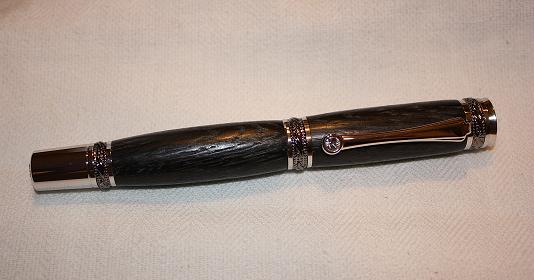

Hello Everyone. This is my first pen post. New to turning (only about a dozen pens so far most of which have been slimlines). This is one of my first big pens which I just finished this evening. The wood is Irish Bog Oak. Any comments / suggestions welcome.

As the resident Bog Oak expert, very nice. I like that you didn't hide the texture of the wood.
If there is one thing I will suggest, work on getting the shape a little more balanced between the top and bottom (comes with practice).
Philip
Best to stay away from high gloss finishes on bog oak . They totally hide the grain to the point where it can look like a piece of black plastic . I use a coat or two of thin CA but don`t go beyond 600 grit .
Wayne
Nice kit and neat wood.
I recognize the type of kit, but where did you get it? Haven't seen that particular design before, but then again, I too am a newbie.
Tim,
Just a little friction polish. No CA yet. Still working on that.
Mike,
Thanks for the suggestion. I see your point.
Well, it loos AWESOME the way it is, no need for CA if the grain pops the way you have it here.:biggrin:
Kevin, very nice. For just your 12th pen you took on a challenge in IBO (Irish Bog Oak) that some (myself included) have waited to do until they had more experience, I tip my hat to you for that. As Mike said work on your shape somewhat, that component set looks better turned barrel to barrel (in a stright line from top to bottom).
I think that a slight curve works well with the Majestic. Nothing too exaggerated though. I think the style of clip a pen kit contributes a lot to how the shape of a barrel will look. I think a straight clip (i.e. Emperor) looks best with a straight barrel, but one with a curve like the Majestic can go both ways. Just my opinion, and everyone has one.. LOL. I do think that the curve on the upper barrel is a little out of sync with the lower one though.
All in all, you should be commended for such a nice looking pen for just your 12th one, and a Majestic no less! :highfive:
