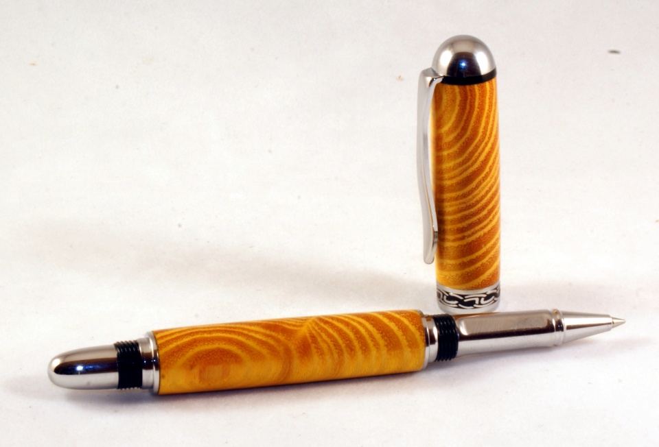

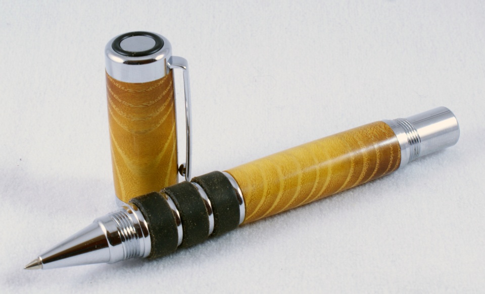

I turn a lot of Osage orange and personally love it. It is tough on the tools, but the beauty is worth the effort. I've been able to amass a lot of different cuts and blanks from several IAP vendors and individuals.

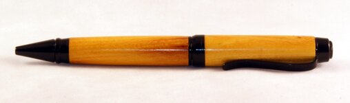

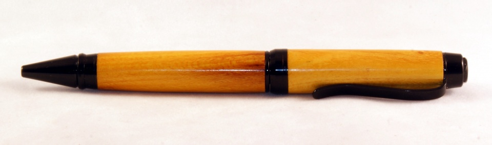

I just turned a cigar ballpoint for a gentleman to replace one that he lost while on a business trip. The Osage orange was more of a straight grain, but still showed some beautiful striping and the chatoyance that I've come to expect from the wood.
Yes, it will start out a beautiful yellow and slowly turn golden with age but it's still beautiful.
