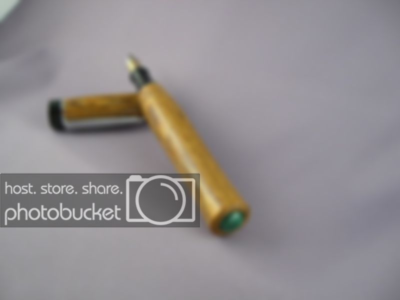

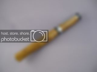

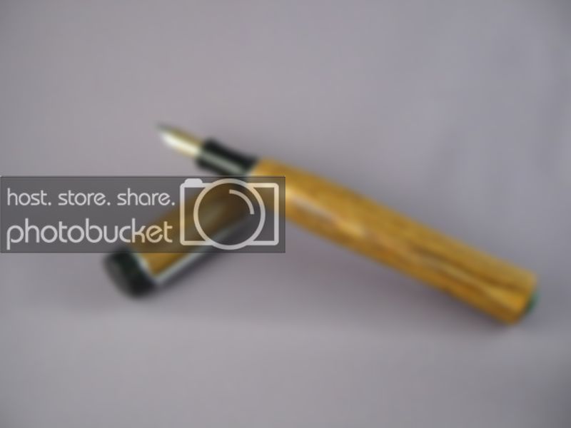

Hi,
Another pen I was working on and finally took some time to make a picture of it. The pen kit is an El Grande fountain pen purchased at Lee Valley. The blank is a bocote. I turned it as a solid end pen, using a pen mandrel from William Woodwrite.
I like the string wood grain in this blank, I added a 10 mm malachite cabochon for a finished detail
The finish is sanding to 400 then Mylands friction polish then microcrystalline wax for a final polish.
I have been enjoying seeing others here make this same kind of pen, here is my version.
All critiques are welcomed:D
Jim I really like the shape of this pen, open, closed it is IMO missing something. I love the shape of the barrel, but the cap is....well I can't really say what it needs shapwise. Not to take away from the workmanship. That's outstanding! As Cav said the cabochon is stunning!
Originally posted by mick
<br />Jim I really like the shape of this pen, open, closed it is IMO missing something. I love the shape of the barrel, but the cap is....well I can't really say what it needs shapwise. Not to take away from the workmanship. That's outstanding! As Cav said the cabochon is stunning!
I agree with you!.....I struggle with the HW and the look of the cap shape. I usually turn the cap first then blend the pen body afterwards....I think the HW design is constricting...
Thanks for your feedback
Now your talking Jim. That's the shape I always strive for in a closed end design. I have the closed end mandrel for the El Grande and only made one but the shape of an El Grande seems to look better in a square or b to b profile. I think it has something to do with the cap and the wide centerband and finial.

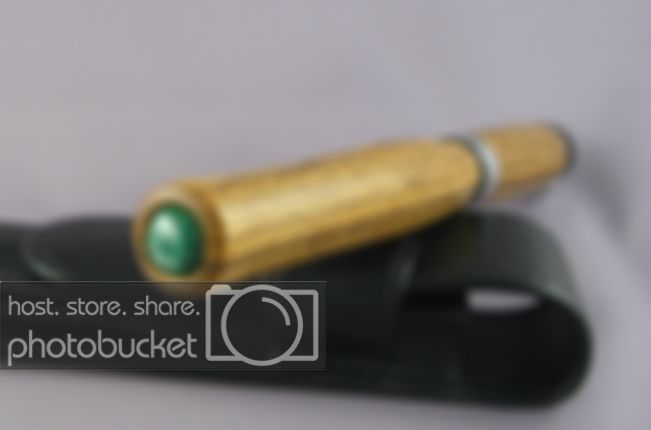

I had a few emails asking for a better shot of the end of the pen, so I thought I'd post the picture here.[:)]
