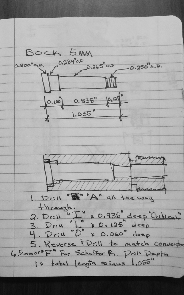

Bock 5mm nib unit dimensions in inches with Drill sizes
More4dan
Mar 17, 2016
2,100
Katy, TX
Attached is my dimensions for the Bock 5mm nib and feeder triple unit. Also my the drills I use to create the front section. Let me know if you have questions or comments. The Tap for the threads is a metric 0.6 pitch while the diameter is slightly over 0.25"

Thanks for the sketch. I have a .dwg and a .dxf of the nib section if anyone is interested. PM me and I will send it. I couldn't upload the drawings to thi thread.
In steps one through 4, (prior to reversal) is the blank mounted so that the outside-threaded end is towards the tailstock or the headstock?
Greetings
I think I uploaded the files properly. There are two .dwgs and one .dxf
Good luck. I did these to the best of my abilities and they work for me in my designs. I hope they are helpful.
Threaded outside end toward the headstock for steps 1-4. I use a chuck or you could use a collet.
