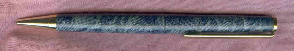

This pen was inspired by Eaglesc. It is bluejean material and lots of Ca glue. It is a modified SL. Should I add a centerband?
ATTA BOY!
Looks more like the Fibermascus than mine,great!
You must have used newer jeans.
Do you really think it takes that much glue?

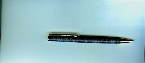

Would it be possible to post a larger(different picture)?
Did you wrap strips or use a large section of fabric and roll it "jelly-roll style"
Originally posted by Eaglesc
<br />ATTA BOY!
I didn't use very new jeans, they some how got battery acid on both sides in the back and had a few holes in them. I used a lot of glue because I soaked the strips as I wraped them. I used strips about 1/2" wide. I also had a few blow outs. I'm going to post another picture later in my album.
Thanks for all the nice comments.
Tom,
Can I be a real pain and ask to see the seam where the material meets? I'm thinking of doing a pen in stingray leather, but I haven't quite figured out how to get a good seam. I'd like to see how the denim came out, since it is likely a little thinner than my leather.
Thanks!
- Jim
Jim
both smoky and I wrapped the material "barber pole fasion"
If you can't see the seam then wwe both did a good job.(we did,if I must say so myself)
Don't look hard but just "look" and you will see a spiral up the blank.
What you are wanting to do strikes me as more of a snakeskin question.
the key to a good seam is straight edges.
Thanks Eagle, now I see the spiral. Neat idea! Yes, what I'm trying to do is probably more akin to snakeskin. I may post a separate request for info as I get a little braver, and after I buy some different viscosity CA's. All I have at home now is some thick stuff, and some dollar-store Super Glue.
