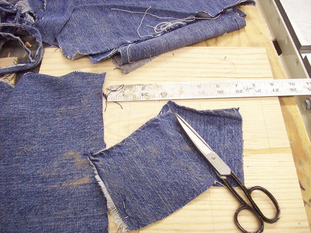

Cut up blue jeans in to 4" squares

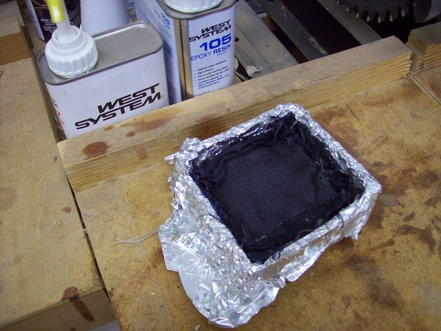

I used several pumps of epoxy and hardener to soak the denim square

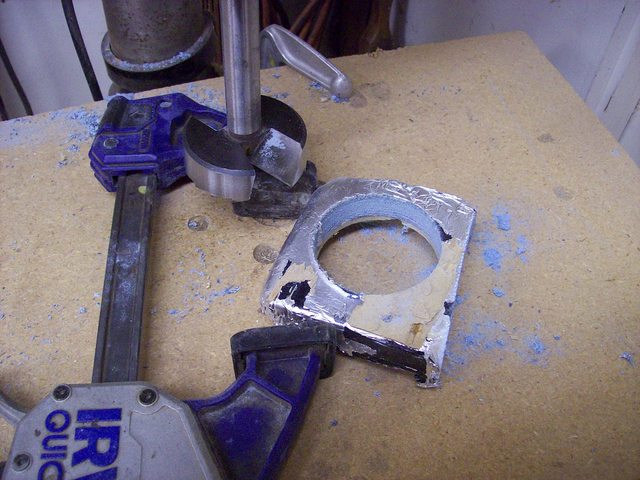

I used a forstner bit to drill out the inside diameter (2 5/8)

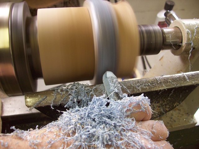

It turned great! I was getting long cotton shavings!
Here's the video:
http://www.youtube.com/v/KP78ZmNXIxA

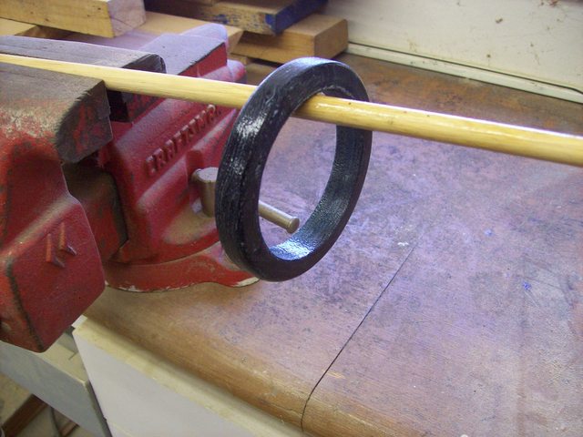

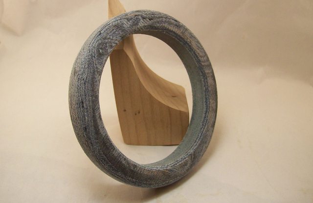

I put a finish on, but didn't like it. Sorta took on a rubber tire look to me, so I sanded it off.
