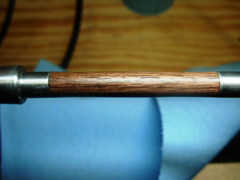

Here is a pic (if I uploaded correctly) (no im not a photographer :) )
Yay, my first pic! Its a walnut blank (scrap from a cabinet shop). You can see some good glassy shine but other parts are more of a matte finish. And its random, not where I just held pressure in one spot longer than the other.

Well, I am going to go in another direction. Sometimes there comes a pen that just does not want to be finished right! :biggrin: I am not kidding. I get one like that every 6 months or so. I will spend a two or three hours on it and give up. I can make a dozen after it just fine and then go back to that one and . . . another hour or two and still not perfect! Several, many more just fine but that one pen . . .
Sometimes out of round, vibration, too much pressure on the tail stock, unsquared blanks (cause wobble) - all of these can cause off center/out of round to the extent that sanding will be heavier in spots which will cause sand through. Sometimes oily woods will cause dulling of the CA in spots when the CA is thinly coating the wood.
Not sure if these help, but I did want to mention them.
Hmm... is this scrap new? unused? Is it possible that it was part of
something else before? Is it possible that there is some sort of finish in the
wood already that might be interfering with the CA adhesion?
Just wondering ..and throwing out ideas.

I'm with Hank Lee on this one. It could be the wood, especially since it is Walnut and you got it from a scrap pile. Walnut can be a beggar to finish because it can be prone to spots of different penetration of the finish as a growth factor in the tree, too much heat from the sanding, bruising from the turning tool, waterspots from exposure to the weather, or any other contaminant that could have been in contact with it in the trash bin. The dark color of the wood accents minor differences in penetration of the finish. Cherry is also bad, and may be worse than Walnut, with its sensitivity to things that will change the penetration of the finish.

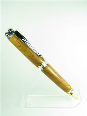

Well, here's my solution to your problem. I tried it a couple of days ago with some cherry that just wouldn't shine after a dozen or more coats of BLO/CA.
I just want to add here, More BLO is never the solution. My opinion and I'm welcome to it.
I put that surly pen blank back on the lathe at ~1800 RPM's and I wet mm'd it from 4,000 grade MM to 12,000 grade. Voila, it shone like a babies bum!
Here's the pen.

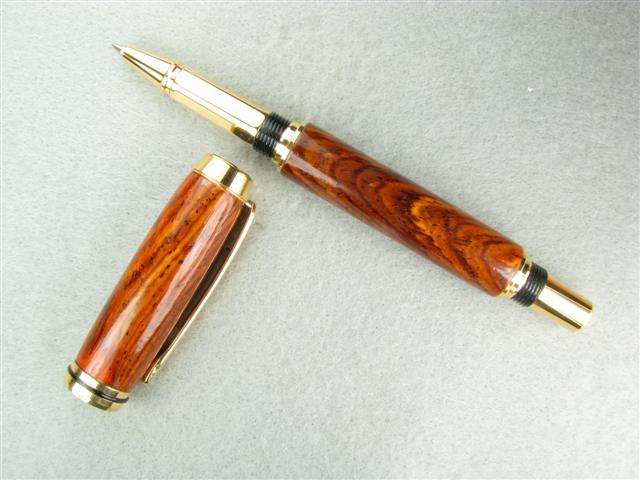

Hi Bill; I'm not familiar at all with the Enduro finish you speak of.
Granted, cocobolo is very oily, but in no way impossible to finish with BLO/CA. Here's a Baron in cocobolo finished with BLO/CA.
It just required a good rub down with Acetone to remove the surface oils prior to finishing.
