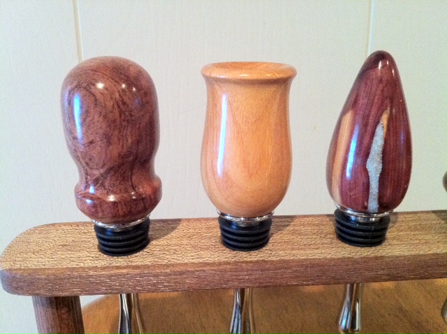

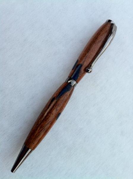

I use crafting sand to fill large holes and cracks. It comes in a variety of colors, with or without glitter. Here is a pen made from mesquite wood with blue sand fill in the holes (it looks like lapiz stone), and a cedar bottle stopper with white fill.
