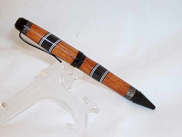

You can use these in combination with other materials to make larger size pens other than Sierras...
Below is an example of multiple materials. I didn't use the material you mentioned, but here is an idea generator for you....
Is is Black with Silver Flake Acrylic, Afzelia, 5 Layer Pic Guard (B/W/B/W/B), and Black Corian
