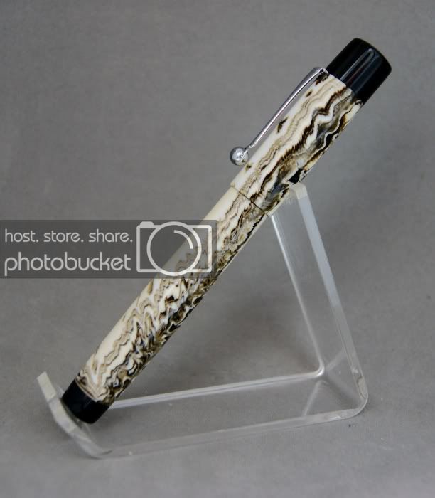

The smallest pen I make that is capable of using a "standard" ink converter has a lower body of 2.8" and a cap body of 1.9" and I use .250" black upper and lower finials with a black grip section so making a pen from one 5" blank is easily doable with a thin kerf saw. I have made quite a few pens this size so the above numbers are fact and not theory.
The lower pen in the photo is such a pen, it uses a standard ink converter and uses a Bock #5 nib and weighs 12 grams .....
