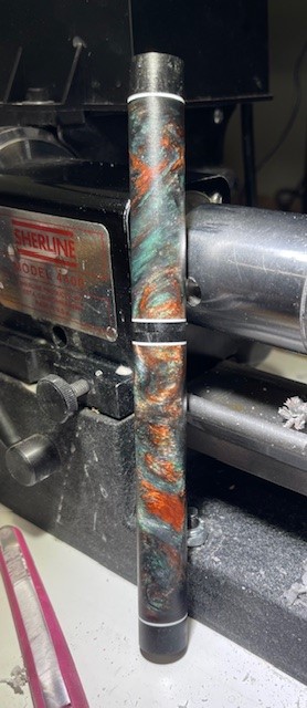

I've always just added on to the ends of the blanks I have. Usually some complimentary or contrasting material. Gives it a nice look. The other option is to look for "kitless" blanks, they are typically 9" long and would be plenty long for anything from Bullseye.
Here is one I'm working on now, just added a little here and there to get the length.
