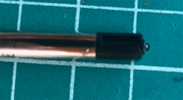

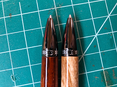

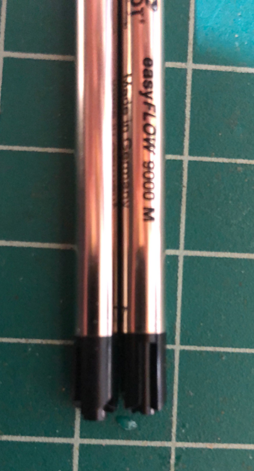

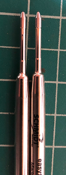

I am hoping that I could ask for some advice. I am putting together 12 Blade pens for Christmas for my son's teachers at school. I have made this kit before and love it. This time I went ahead and upgraded to the Schmidt 9000 refills. I turned all of the pens, and when I went to assemble them, I realized the refills were not coming out of the nib enough, making the pens unusable. I thought it was something with my turning or that the blanks were cut too long, bad presses. I come to realize that the Schmidt 9000 refill is not exactly the same size as the included refill. The Schmidt seems to flare out less at the spring, and it also is a tiny bit shorter on the plastic piece on the end of the refill. When I use the included refill, everything works fine.
Does anyone know of a workaround to make the upgraded refill work in this pen? I was thinking about adding a drop of solder at the bottom of the Schmidt click mechanism to make the refill protrude a little more. Is there a more standard workaround for this issue? Perhaps a different spring? It's not easy to see in my pictures, but the little extra that the original refill protrudes makes a big difference in usability.

Hi Mark, did you get these from Exotic Blanks, as they appear to be the new Schmidt 9000 without labels that they are selling. If so, I would contact Ed at EB and ask him to compare their label-less 9000 refill's length to a standard parker type refill. There are several things you could do to fix your pens. However, I would suggest your "fix" takes into account what parker type refills your users are likely to get in the future.

The picture showing the issue is not the best, but it is just enough difference to make the pen skip occasionally when writing. Unfortunately, assembly is done. I tested the first of the bunch with the original refill, and everything looked good, so I finished the rest. It wasn't until I was done that I dropped in the Schmidt refill and noticed the problem.
I may have found a solution. I put a bead of thick CA at the Schmidt refill's tip to give is just a little bit of length needed. The refill seems to be working well now. Think this will hold up?
