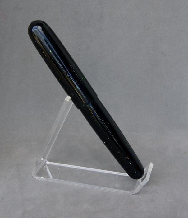

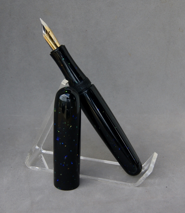

Yet one more fresh off the lathe. This one I'm VERY happy with. The pics just don't do it justice so I shot a couple 30sec videos that I'm hoping to embed. Hopefully I remember how to do it.
So I was experimenting with some alumilite and came up with this blank. It turned and threaded very well. However, I did end up needing to apply a CA finish in the end to really bring out the opalescent look. It's another clipless design.
Almost forgot the specs!
Overall Length: 5 1/2"
Cap Length: 2 3/4"
Body Length: 4 3/4"
Threads
Cap/Body: 14x.75mm Single Start
Section/Body: 10x1mm
Nib
#6 Heritance
