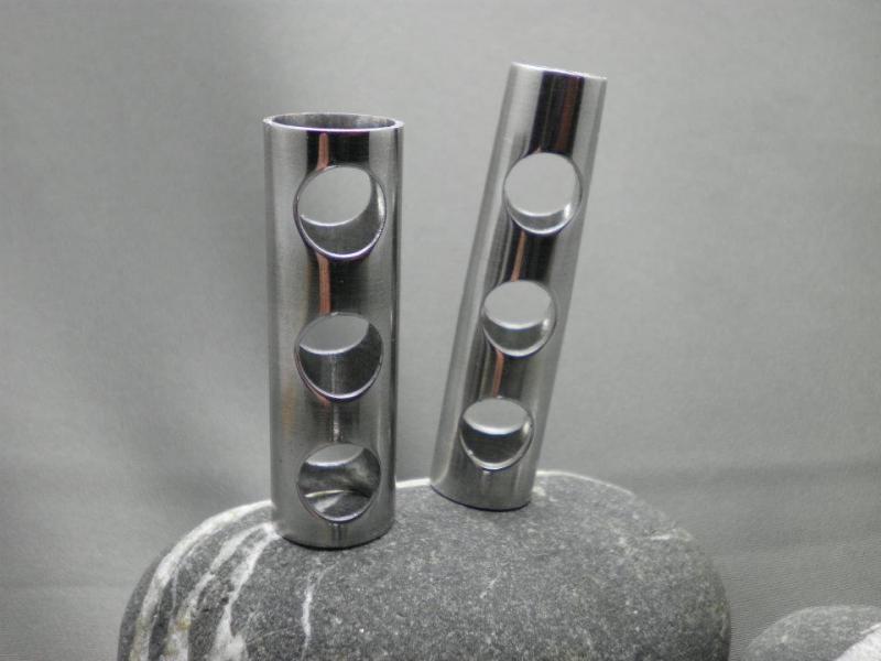

Pic 1)
Shows the two pieces of the pen made from aluminium

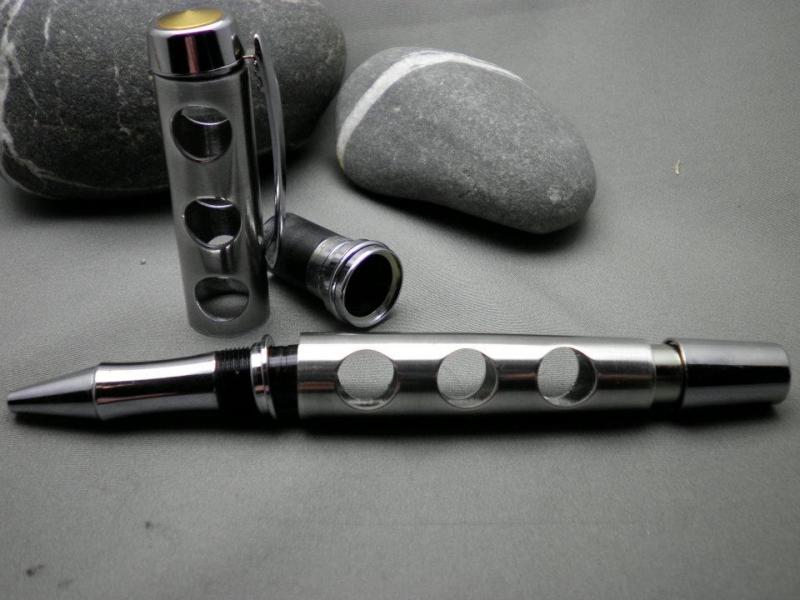

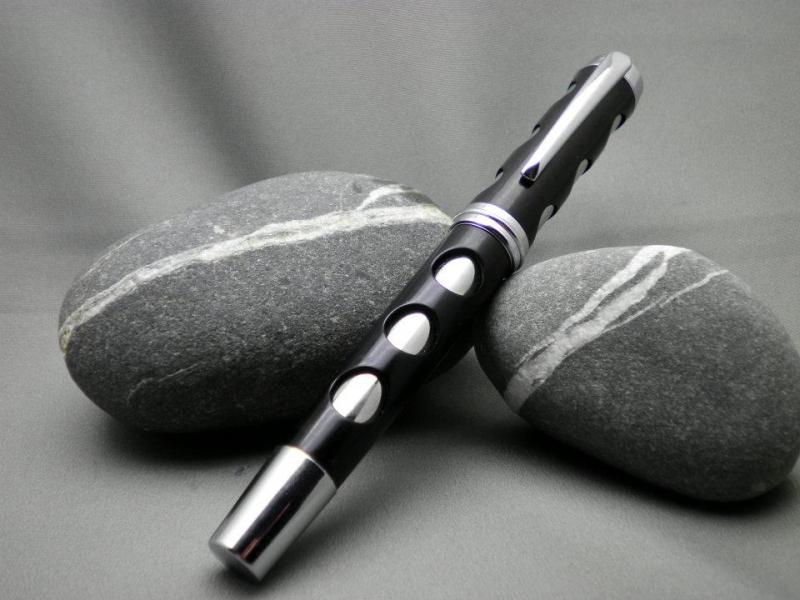

pic 2)
The pen loosely fitted together so i could get a feel for the design

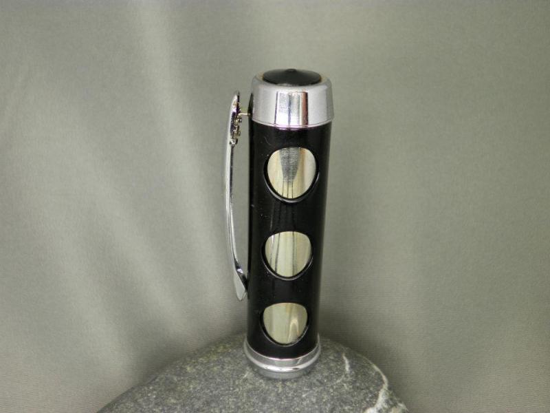

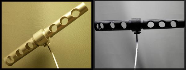

Pic 3)
on the left, the parts mounted on the jig and anodised. On the right, the parts after they have been removed from the dye tank. if you look closely you will notice the finial mounted on the underside of the jig

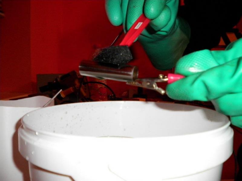

Pic 4)
Two brass tubes buffed to a high shine

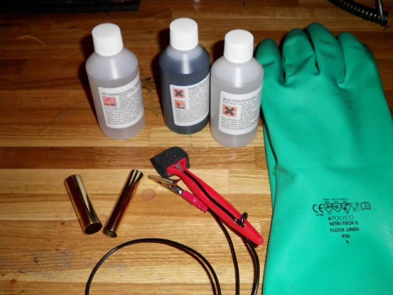

Pic 5)
Chrome plating chemicals and apparatus

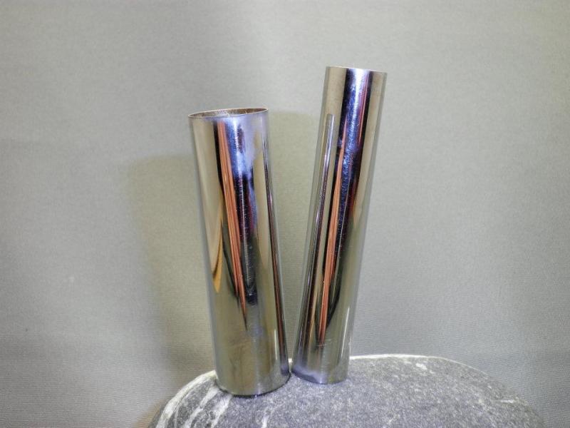

Pic 6)
And the brass begins to transform into a lushious shine

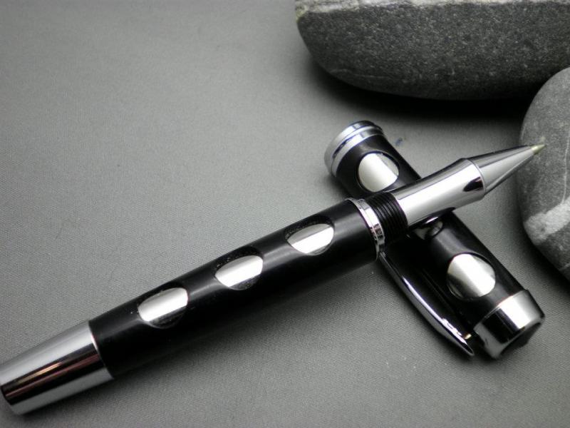

Pic 8,9,10)
Another one im pleased to have in the collection

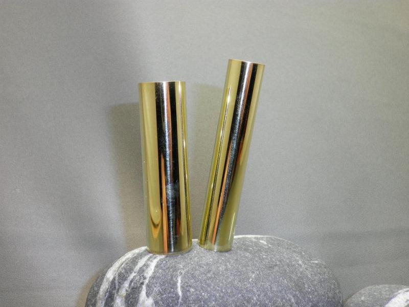

Pic 4)

Pic 7)
Viola.. two chrome tubes
