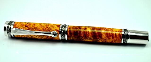

I was bored with nothing else to do, so I used one of my last kits. It is Black Ash Burl on a Majestic Kit. I am not a fan of these kits, at all and I know, I know, it still has the "pimp" stone but it's hotter than Haiti in Houston right now!! Turned down corners with gouge and completed turn with skew. Sanded to 600, then applied 10 coats thin CA. Wet 400/600 and wet MM all the way up. Finished with Hut and Ren.

That is a fine looking item, Shawn. I actually really love the Majestic kits. I've been carrying one daily for a couple of months now and it's the best pen I've ever had.
I love the weight of the pen but I think the stone takes the focus away at times. I like the Jr Gent/Jr Statesmen style the most. Thanks for the compliment. It's much appreciated. Thank you.
That pen is looking really nice. I don't think the crystal takes away too much attention. I am focused more on the wood. It looks great! I really like the look of the Black Ash Burl there.
Really nice wood, I'm a sucker for black ash burl.
and sometimes more coats of finish the next day if you can't get the shine.
try a top coat or two of medium ca, over the thin.
Shawn, That is a beautiful looking pen. The wood is gorgeous. I think the crystal is appropriate on a pen that is elegant looking as yours.
Was the Black Ash stabilized?
