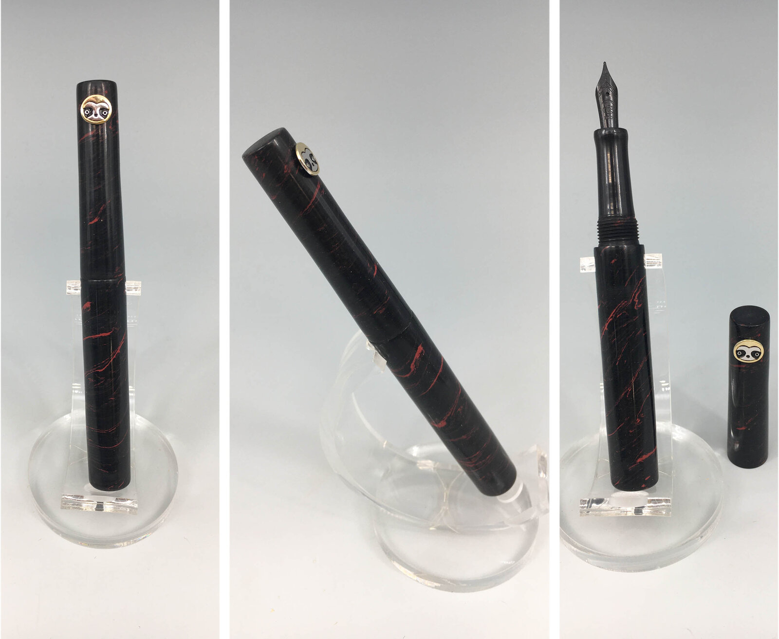

Afternoon all, During the last lockdown here in the UK I've taken up the Kitless pen challenge. Little afraid of showing the pen here, given all of the stunning creations gracing these pages, but hey, it's a learning process that (after a few disasters) I'm finally becoming more confident in.
Herewith find my Sloth pen - turned from Black and Red swirly ebonite, with an ebonite section and a black Bock #6 (F) nib. Oh - and a Sloth rollstop in the cap. Capped 137.2 mm, uncapped 129.3 mm, section 26.43. Barrell diameter 15.42 mm taper to 13.08 mm at the cap.
Be honest with any critiques you give, as that's the only way to improve.
Thanks.

Very admirable job on that pen !!!!!
I like the overall styling !!!
I especially like the continuous diameter .... body, cap the same where they come together !!!!
Where did you buy that Ebonite, please ? . . I really like it and would like to get some.

Thanks. I'm still working on the shape and dimensions. Doesn't quite sing to me yet. Feel like the cap ought to be just a little shorter. The ebonite was sourced from https://www2.theturnersworkshop.co.uk/shop/pen-blanks/ebonite-hard-rubber.html
Chriscb
Gorgeous! Love the roll stop. Do you know what the material the ear ring is made from? Just wondering if it could be bent to match the contour of the cap.
Thanks. The material is silver, plated with rhodium. Interesting thought about the contour of the roll stop. Not sure if doing that would reduce the effectiveness.
