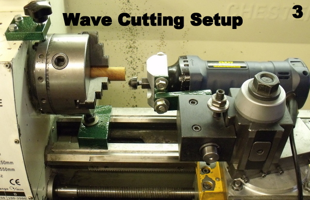

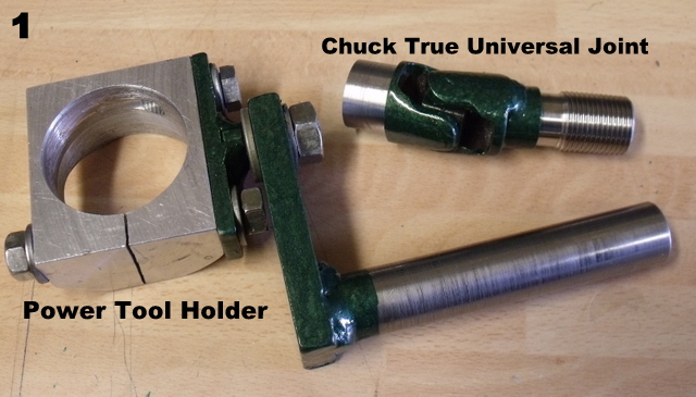

Today I made a new tool post power tool holder. It works great and I'm pretty pleased with it. :biggrin:

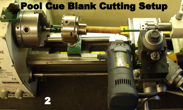

I then decided to try a new way to make Pool Cue Blanks. Up till now, I've used a Heath Robinson flexi joint that worked but was a pain as the blank had to be glued to it.
This new one is a highly modified socket 'universal' swivel joint. The main problem with these is that they aren't true universals as the two axis' need to be the same. It was tough to alter this one!! It has a threaded end thet screws into a 4 jaw scroll chuck. A boring head in the tailstock creates the offset.

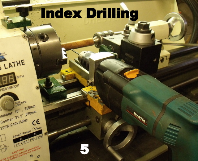

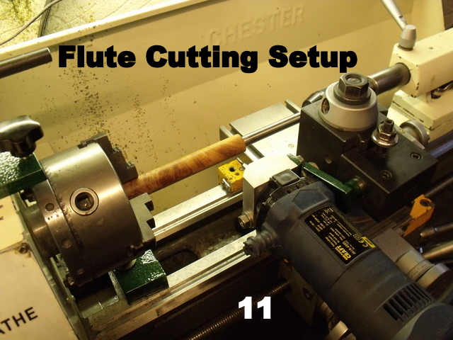

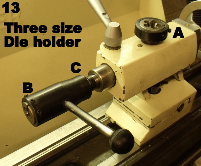

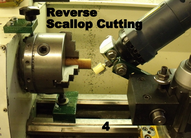

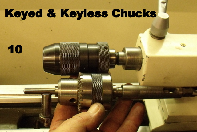

I then just took a couple of pics of some of the attachments that I use the most on my lathe.
When folks ask about which ML to buy, I always advocate a bigger one.
I couldn't do half the stuff I do on a smaller lathe.
I think the pics are self explanitary, but please feel free to ask anything :wink:

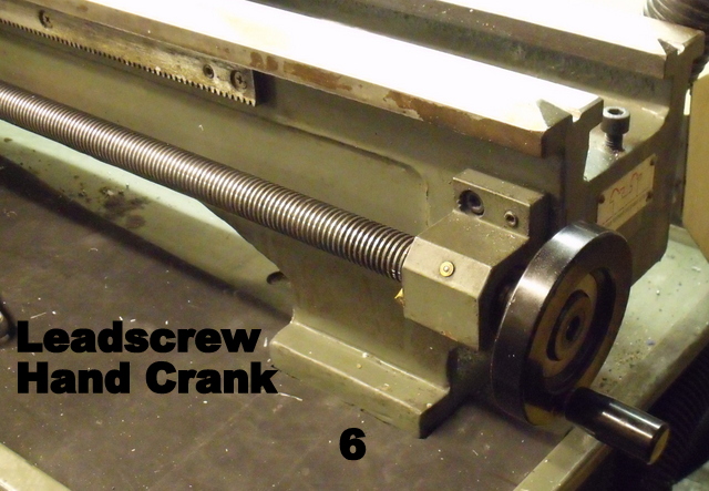

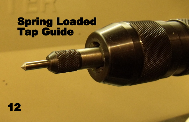

no worries ;) thought the thread cutting ones may catch your eye.

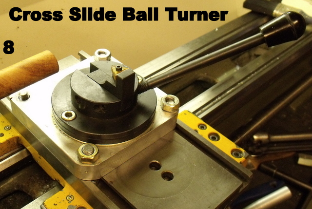

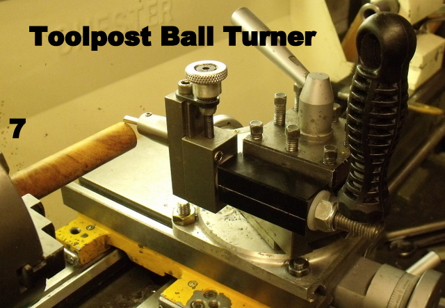

Im envious that you have ball turners... keep meaning to get around to that.
Brad, if you get a ball turner, then I recommend the Cross Slide one. The other one in the toolpost works well but takes more faffing around to set up.

did you build your ball turner or buy it ready made?
No snickering.................
Nah, bought them both, Mike. The bigger cross slide one is really basic and would be easy enough to make though.
I will be making one out of my boring head though, just to show the versitility of them. :biggrin:
Cheers Steve ive eyed up both versions in the past il sway more towards the cross slide one, though im holding off tooling until i get the new lathe :biggrin:
Interesting thought on the universal joint. Have seen the boring head used to offset in the tail stock. Neat stuff!
Hi Paul. I know you are a serious machine guy and so you'd already know this, but for the benefit of anyone that doesn't understand,.....in this setup, the lathe is unplugged and is used ONLY for the indexing and work holding.
:biggrin: Any petrolhead knows what a universal joint on a prop shaft looks like but have a look at a universal joint in your socket set and see if you can figure out why it had to be altered. ( no prizes, just for fun ):biggrin:

Not trying to knock your ideas, but, and this is just a thought, would it be possible to do without the extra chuck, uni joint and boring head by making a taper turning attachment, (with micro adjustment) as per Model Engineers Workshop issue 178 and 179? I made one and it works by disconnecting the top slide so that it slides back and forth, following the set taper, as the carriage is moved along. To me it would save a lot of extra setting up!!!
I've not used it for pens but for turning Morse tapers.

Hi Kryn,

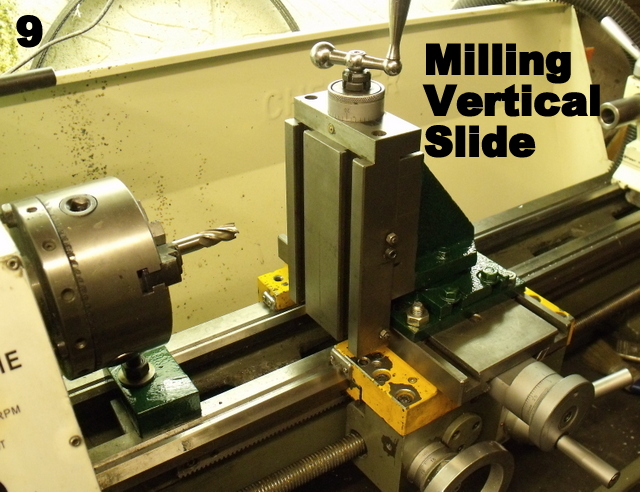

I did try the Taper Turning Attachment route. I half completed one a while back. There are many cool plans on the web for them. But for me, it won't work. I plan on using the back of my bed to affix a milling head. The back side is already machined square and has the mounting holes already drilled and tapped.
I also don't like the idea of having to dismantle the cross slide crank when I want to use it.
Now that I've got the stuff, it's 6 or two 3s on the time it would take to setup either method.
Of course, I wouldn't run the machine in this setup. If I ever need a long taper ( too long for the top slide) then I'd just offset the tailstock and use a lathe dog on the headstock. But you are correct, a TTA would be ideal for most uses.:biggrin:

Sweeeet stuff. I like the router attachment. Looks like a few passes with that and you have yourself a nice blank ready to go. Thanks for the pics, now you have me thinking......
