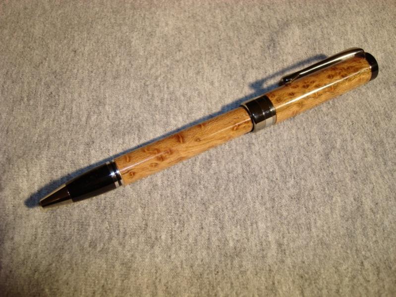

Had this piece that had some slight voids and darker coloring in it and smelled a little like spalted wood. turned it and finished with CA. I'm starting to think that I prefer med. CA to thick CA for finishing because it dries a little faster. All comments and insults welcome. :biggrin:

I love turning BE maple, and this pen is an excellent example of why! Great pen. Did you just use ca to darken it up?
I love the wood. Nicely Done.
I use med. for finishing. Even without accel. it still goes pretty quick.
That turned out great. The eyes are just the right size. Great job.

Nice pen, a real pretty piece of birds eye maple, I agree about the Med vs thick CA. I seal with a few coats of thin then start laying on the medium, your finish looks great.

Can anyone tell me how to darken BE maple. I have some, but it is pretty bland.
Thanks, Midi
Use some BLO, It darkens it a bit and help showcase the chatoyance. You can also put a smalll amount of stain in the BLO. The wood wisperer had a videopodcast on how to make Maple POP and had a recipe for the mix.
