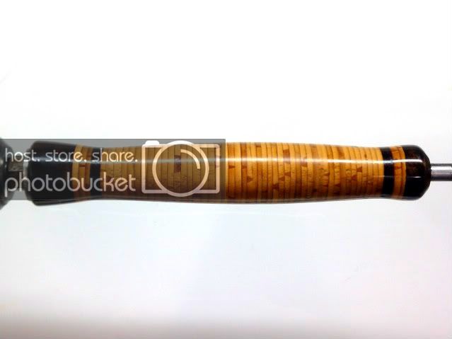

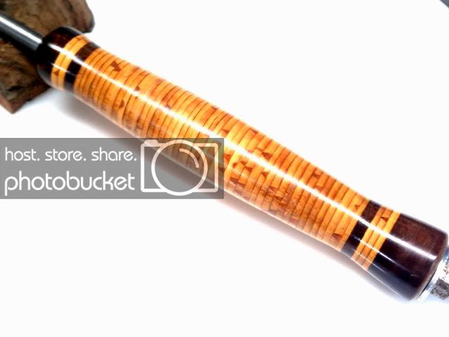

Just wanted to share one of my recent projects. Here is a Birch bark handle with Rosewood burl trim pieces.
The handle measures 6.75 inches and is finished with 6 coats of Linseed oil and CA.
I appreciate your comments.
Cheers
Wow, very cool. Not to sound stupid ( I now too late) but is that birch bark stack laminated? What type of glue did you use...very interesting, thanks for sharing
The birch bark was striped of from fallen trees I had behind my parents house and after a thorough rinsing with the garden hose I set them out to dry. I recommend pressing them flat as they dry to keep them easier to work with in the future.
I used Titebond 3 in between each sliver of birch bark and them pressed with a wood clamp. When finishing the handle I used several coats of Linseed oil before applying 6 layers of thick CA. Sanded with 320 up to 1500 wet.

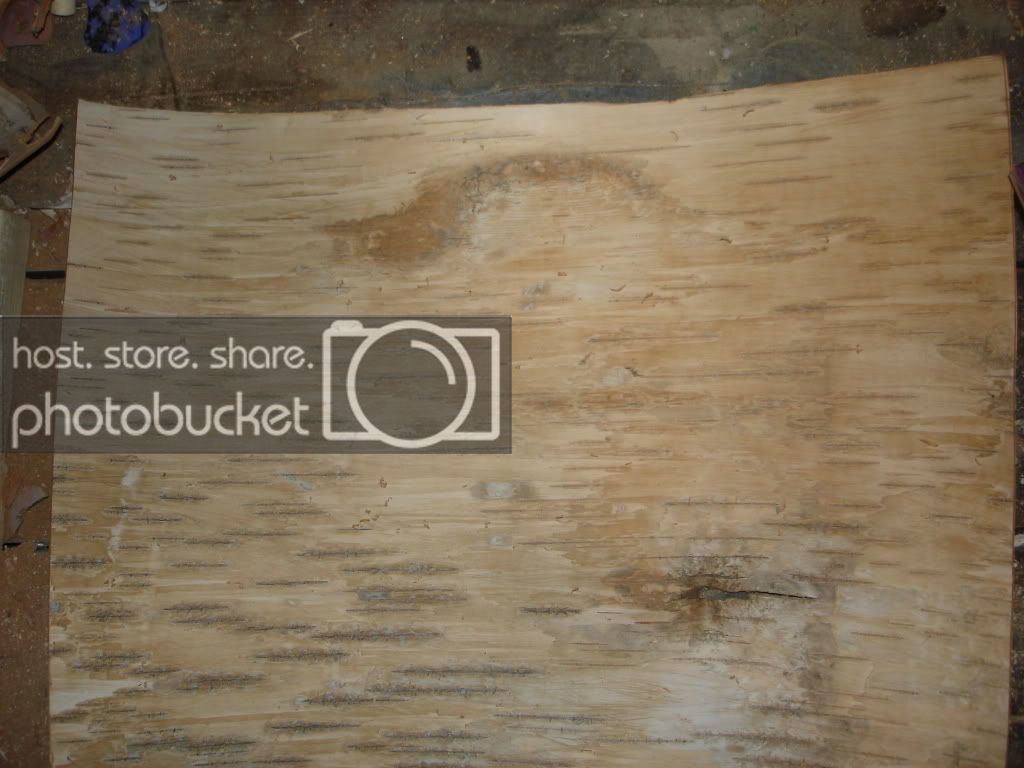

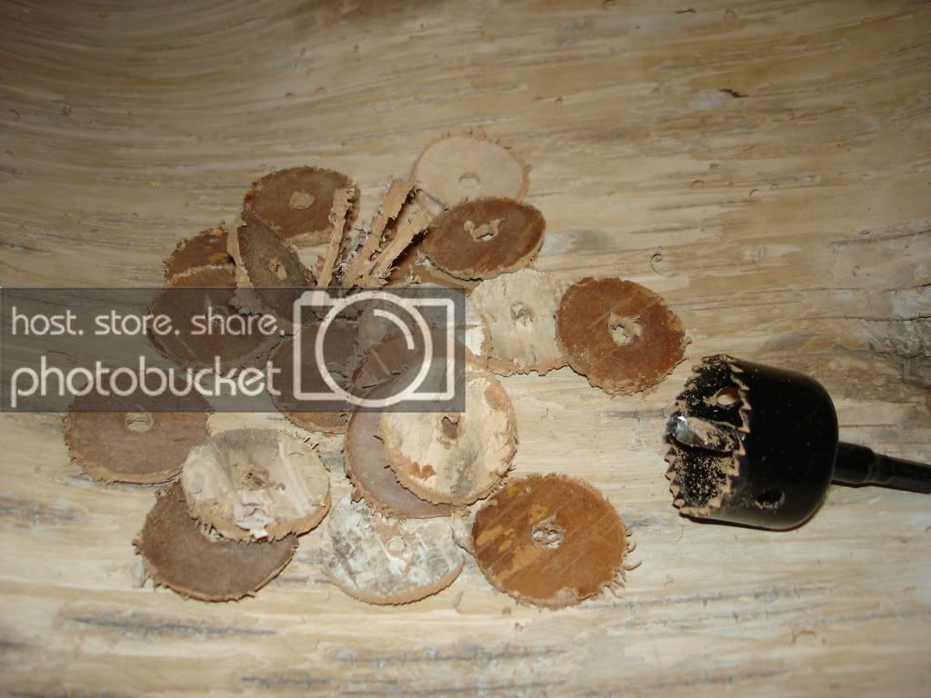

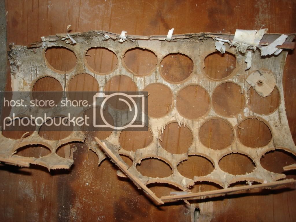

Here are a few pictures from my learning expereince with cutting birch bark. Now I simply cut them square, glue and then turn on the lathe.
Thought I would share for those interested.
FLAT SHEET OF BIRCH
BIRCH RING CUT OUT
RINGS AND 1.5" HOLE CUTTER
A SINGLE BIRCH RING
In my expereince with making these handles it take between 65-80 rings to make a 6.5-7 inch fly rod handle.
Hope you enjoy

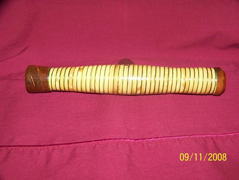

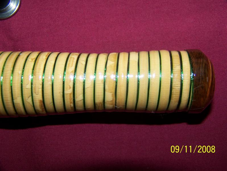

i thought tat was rattan till i looked at the end of the thread. i really like it, its very nice i wish i had some of those trees around my house. this is a rattan grip i did for a 6-7wt fly rod i did about 2 years ago. the picts were taken befor the finish was put on
