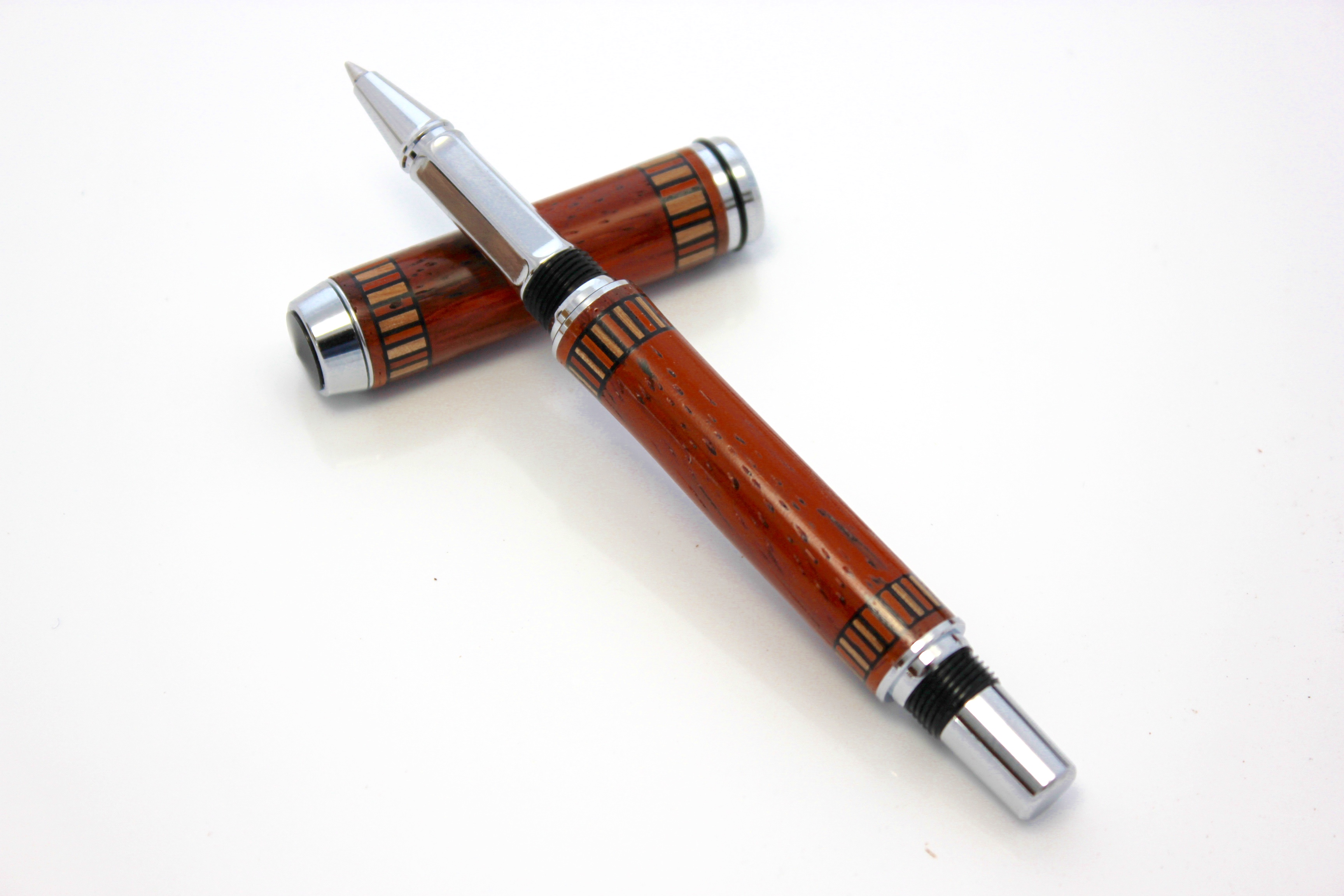

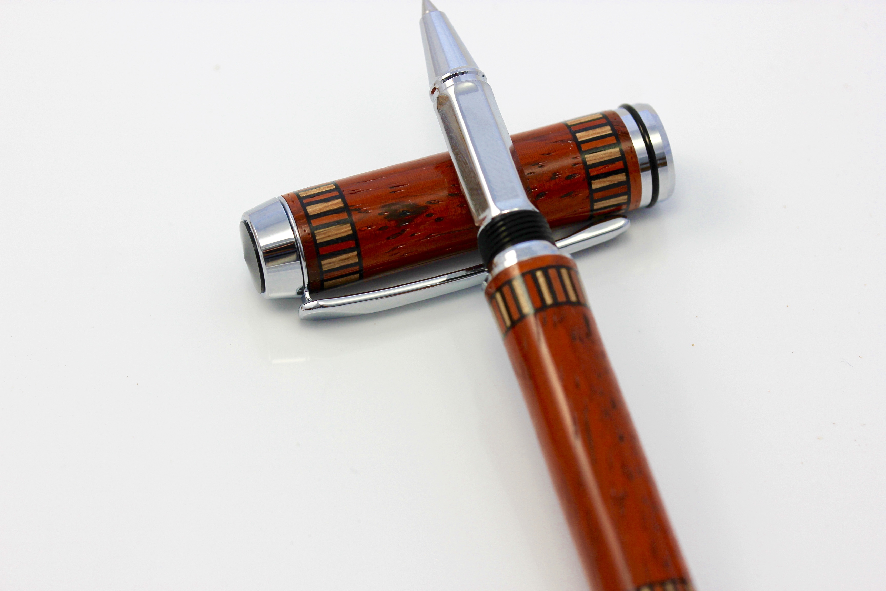

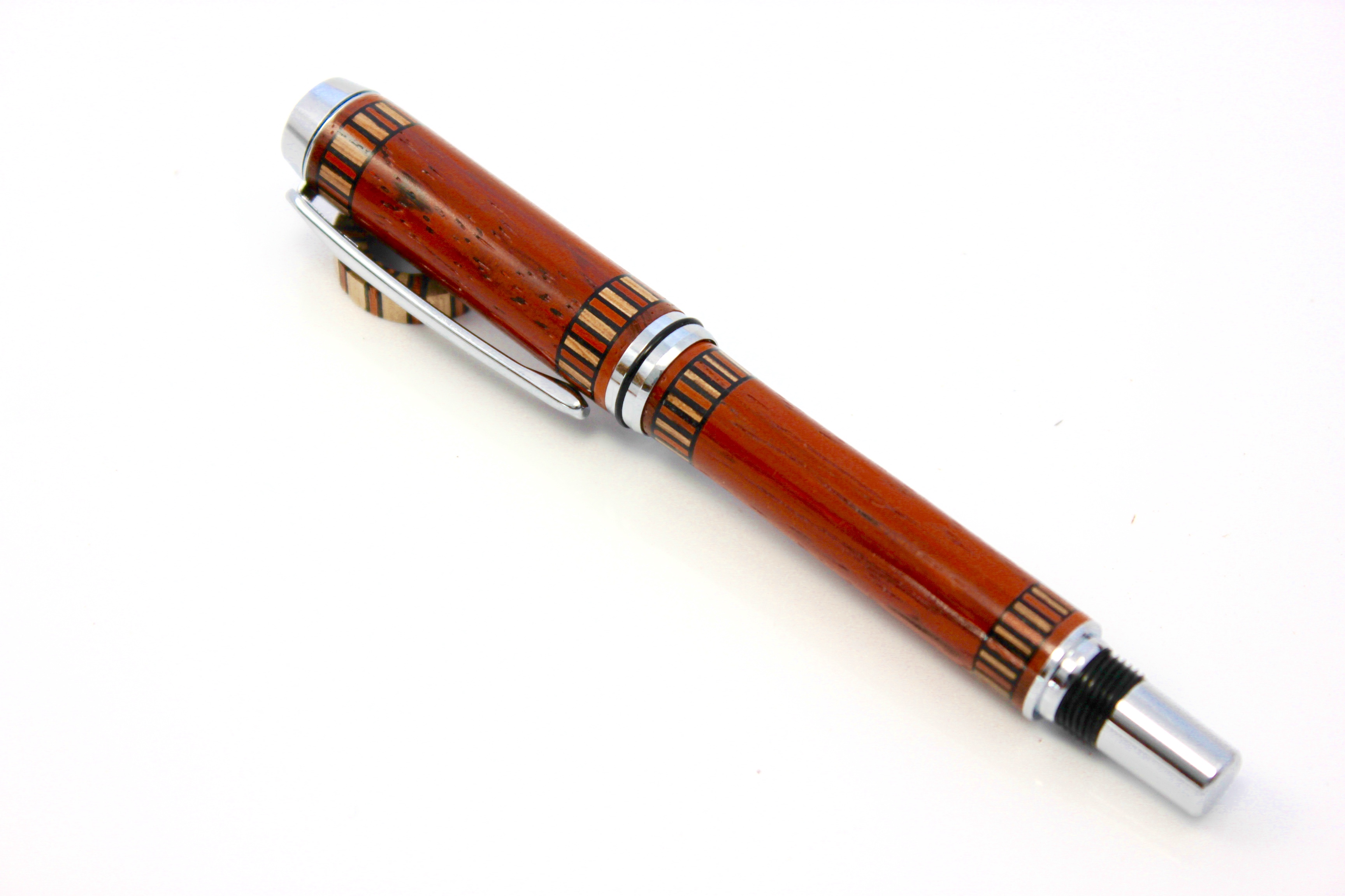

Padauk and Black veneers. Slots were .077" . I started with 1/16" Padauk and had to sand it down to about .04" to allow the inserts to fit. Black veneers were about .023". The 4 1/2" long blank will probably accomodate 2 more pens; although I think a format with the rings on just the top blank will be nicer. Then there will not be the difference in the inlays as the diameter difference makes this noticable (not bad, but kind of bugs me).
I think I liked the thinner billets on the first pen, but this came out nice.

Look great
Very professional looking .......................
The slotted rings normally look better if they are not real wide .
I have made that mistake several times myself
I have also seen where guys double up on the trim rings and they don't look so good either.
Billet rings ,,, a cue make developed using slotted trim rings in pool cues , he was copying poker chips............:wink:
Mark You have done a great job on your billet rings ..
Ever thought of using brass shim stock :wink:

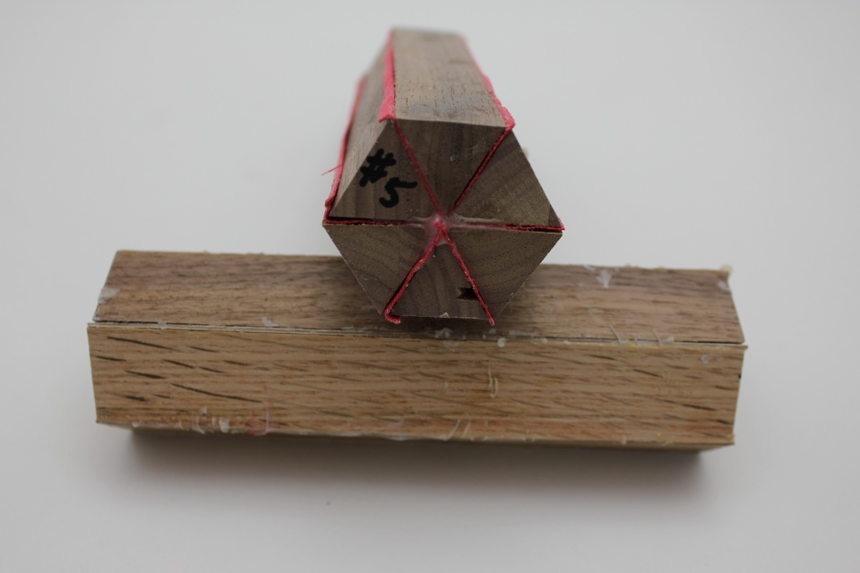

Making the billet/trim rings requires an accurate indexing head, or you use the stave method, or you'll need to be a magician. :tongue:
HI Pete:
Yea, I tried his method last summer and have a whole coffee can of staves that were not accurate enough IMO. He does "magical" work for sure!
A few came out OK, but my failure rate was pretty poor.
The key thing with staves is to get the correct angle. It really is an easier way of doing them but you would probably could not go below 12 staves. It would be a challenge.
