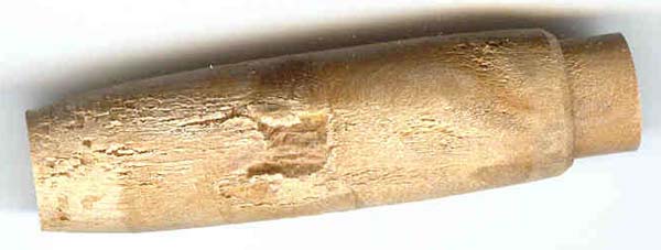

Last night I tried turning a European with some big leaf maple burl I have. The wood is beautifully figured and I was looking forward to a knock-out finished pen. Didn't happen that way. The wood was so hard that turning, with my 1" very sharp skew, produced dust not shavings. And, worse, when I went to sand I noticed the (fast turning) wood was not smooth. Turning off I found the rough areas and this large inclusion. A ruined blank. :(
Bigger dissapointment is thinking that the balance of my block of wood (about 6"X6") might be worthless for turning. Should I get this stabilized? Might be an odd thing to do, make very hard wood harder. Ideas?
Maybe you could put something in the inclusion, perhaps some inlace or crushed stone. It would definitely make for an interesting pen and perhaps save it.

Jim, I will probably have the rest of the wood stabilized. Personally, I am not real fond of turning rock-hard woods like Dymondwood. But this is a nice hunk and I hate to waste it. As for the piece pictured, it is a write-off as far as I am concerned. That filling with grindings and dust and CA is just not my style. Maybe some would say that is being lazy and/or non-creative, but I like wood and prefer to the beauty of the wood to stand on it's own. Uh-oh! Have I started a new debate? [:0]

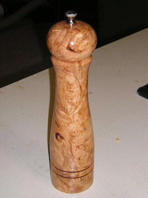

Here is an example of a tough to turn Big Leaf Maple Burl done with CA and epoxy to help harden.
<br />
Bill, that's REALLY pretty!
Frank, have you checked the depth of the inclusion? Is it deeper than the bushing? What about adding some coves to the pen (ala YoYoSpin) in the area of the inclusion?

I think he needs to send that pepper mill to me so I can spend the next ten or fifteen years examining it very closely. [;)] Beautiful, and a great use for a nice piece of wood.
Yes, that inclusion is pretty deep. As for my hang-ups about fillers and CA and etc. Notice, I never said I'm not a hypocrite. [:p]
I'll keep that pen half for a while until adrenaline comes back down to normal levels for me. We'll see what happens. Like you, I hate waste. I just finished the European using a hunk of antler I had glued up a long time ago for the top. Not bad result. I won't post a picture, it falls a little short of brag-worthy.

Sounds like a deal Frank!! In trade though you'll have to send me that stock (gun attached) that is in your photo for "what do you look like?" You know...the tiger one.[:D] Oh, forgot to tell you...you'll have to go to Japan to pick up that pepper grinder as I shipped it there in January!
