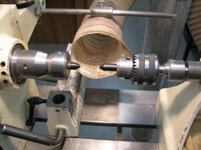

I just use the bushings to get close, .020" or so, and then remove them and put the blank on some Delrin centers I make. This makes it real easy to remove them frequently for accurate measurements and the CA won't stick to the Delrin.
