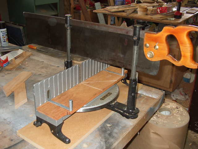

This what I use most of the time, but then again I'm sort of a hand tool nut too. Its very accurate too.:wink: Cost me $20 at an estate sale.
