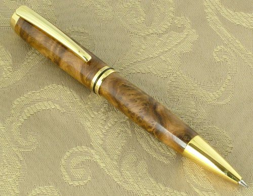

I've honestly only done a few pencils but the one I like best is the Jr. Gents Pencil. It has twist operation and is a really comfortable fit. I don't know if it's too big for your wife's liking but it seems that a lot of women like the size of the Jr. Gents series. Here is one that I made not too long ago and it's the only pencil I use. Good luck in the search, Griz.
