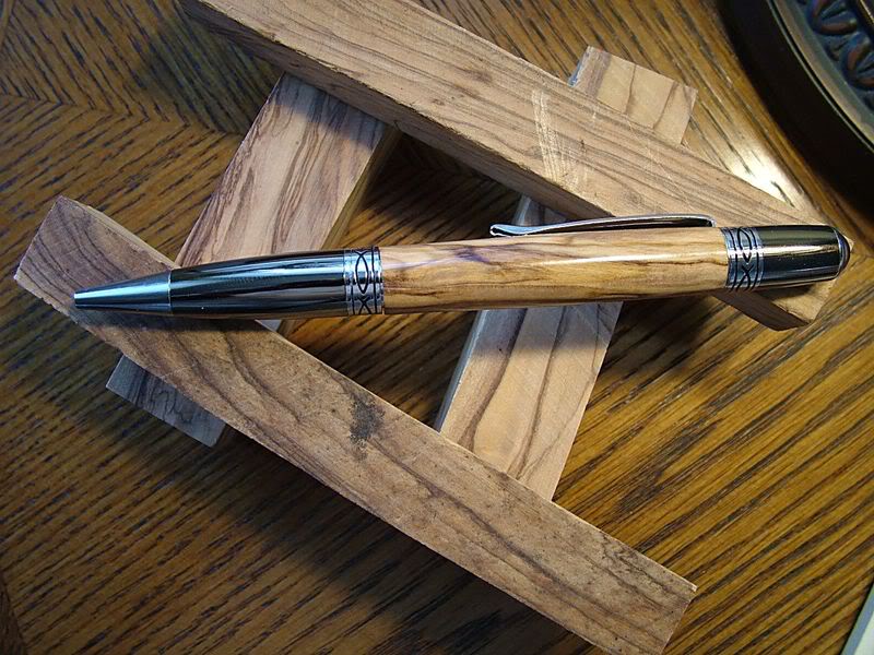

I just tried out a BLO/CA finish on a BOW blank and it looks very nice. I cleaned the wood very thoroughly with denatured alcohol, which I believe made a big difference. Only time will tell if the finish will last.
