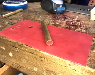

I saw Zac Higgins use a "mystery sheet of material" to plug the ends of the tube and emailed him to find out what it was.

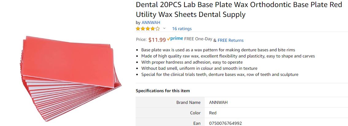

It was this. Probably enough to do 1000 tubes for $12. No muss no fuss, tight fit seals the end of the tube, glue doesn't stick to it. Takes about 2 seconds to do.

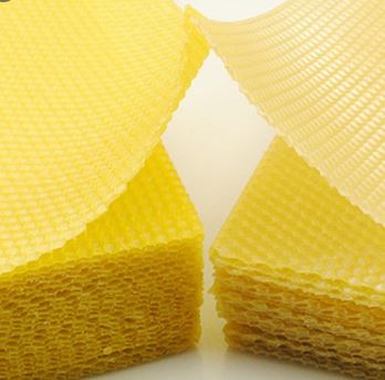

Greetings from Nebraska! I use Broodwax sheets (bees wax foundation sheets for use in beehives). They are made from beeswax and are used as a foundation for bees to use when they build their honeycomb on the frames inside of beehives.
They work pretty much the same way as the dental sheets that you have shown. I poke my tubes into the wax and then clean any wax residue from the outside of the tube with some denatured alcohol to prevent any issues with glue adhesion on the ends. The sheets are relatively inexpensive but usually only sold in larger quantities - I think they come in on the order of about 4 sheets per dollar.
They are even cheaper if you have a neighbor that is a beekeeper. Buy some honey and beg a couple of beehive foundation sheets! When I run out I will probably try trading a pen for a few sheets.

We have had it available for several years--since we saw it at our dentist!!
Holy Moley Ed. I had no idea. I'm a loyal customer of yours. Never heard anybody mention it. I thought it was a new "thing". I ordered it the same day I placed my last order with you. Sorry. . Much better deal with yours as I now have much more than I will ever use.

Yep. Been using dental wax for 20 years. Nothing new and no mystery. But, there are several other choices. I just never had a reason to try any of them. Dental was works great for me.
Ditto...I also watched the Zac Higgins bit and bought the dental wax. Works fine for me. :cool:🖖
