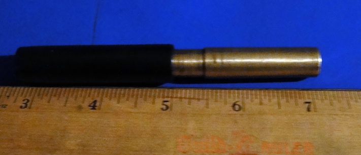

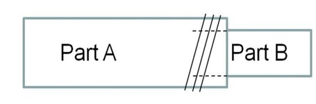

I do a combo of the above with a twist (of course, I had to be different). I like the Mike's idea of using mandrels. I use the tap as one too. For the barrel, the nib section has to thread in so I end up using that tap to hold it on the HS while a male bushing fits to the TS. If it is not a through hole, but a blind one, I make a compression tip for the TS to fit the end. Same goes for the cap.
I make mandrels in brass that incorporate the same threads used the barrels. Since the diameter over the threads is larger than the interior diameter of the barrel, these need to be made in 2 pieces. I start with piece A and cut a male thread. This is either the equivalent of the cap thread for the top or the section thread for the bottom barrel. I then drill and tap the threaded end of A so that I can screw a threaded piece of B into the end. An important step is to make sure A and B are parallel. This can be done by chucking A in the lathe and taking a few passes on B. Now B can be chucked in the lathe and A is turned to the inner diameter of the barrel just up to the threads. Once a barrel is drilled and threaded, it can be screwed onto part A the mandel and is supported by its length.

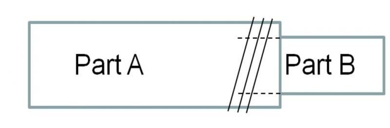

so, if I understand correctly, part A goes into the pen body, and it threads on it too, and you chuck part B into your collet chuck when you turn.
is that right?

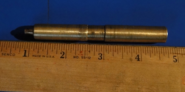

Alex - you understand correctly. Here are a couple of photos of one cap blank. This one has the triple start 12mm threads. First photo is the mandrel, part A on the left. Second one is with a drilled and tapped blank. Piece on the right goes into chuck.

It also helps to have a shoulder just to the right of the threads in the pic so that the cap squares itself against the shoulder. That way if your hole size is a little big , it still squares itself
Why do you need to make them in two pieces Bruce? I made mine in one piece and they work fine. I also dont have to worry about the two pieces lining up perfectly. The mandrels are long enough to support the blank from the inside, not the threads, and there is a delrin bushing to butt up against.
Yours look fine, and I like the Delrin stop - will have to include that.
My die holder is solid on the back so when I start threading if I want to hold it in the tail stock I can't start the threads several inches in. If I had a die holder with a through hole I would do it in one piece.

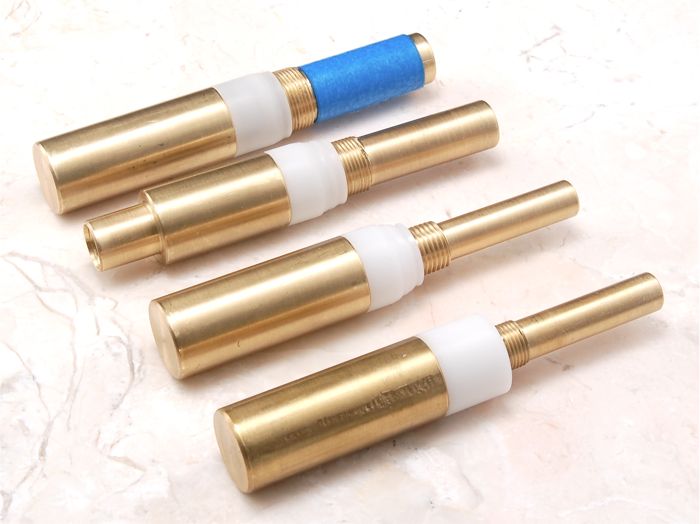

Yep...its just threaded. The threads on the mandrel are 1" long and the delrin bushing is 1/2".
I was going to make mandrels out of Delrin vice brass. I have the delrin rods and I was not sure of being able to turn brass ones. What are the disadvantages of the Delrin vice the brass? I assume durability and rigidity.
Nice looking mandrels Justin!
Does the section get supported by the mandrel? I'm assuming the blue piece on one is a padded ring, to support the section being worked on and is swapped between mandrels for different sections? Could be wrong though!!
Phil
What you said is true. You are going to loose rigidity and be prone to the piece flexing and causing chatter and getting out of round. I wouldnt use delrin unless it was a last choice.
Phil
The blue is just blue painters tape. Its only there because i had a design change and the mandrel is now to small, so i had to put that on there to make up the missing diameter. The pieces are supported from the inside by the brass. For turning front sections, the second mandrel from the top, on the back side, i have it taped to accept my front section threads.
Can the brass rods be turned on a wood lathe?
Yes it can, but what I think will work better for you is to buy a size of rod you can chuck, then just turn the the tennon to thread. That way you chuck the un-turned part which will come to you more accurately round and straight than you can likely turn it on a wood lathe.
