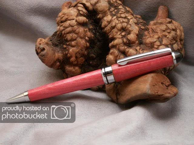

Friction finish for me, just because that's what I like the best. There's a coat of thin CA at 320 grit, then medium CA at 800 first, then friction finish after MM to 12000.

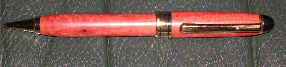

I used Deft lacquer on this on and the color is the same now as when I turned it about five years ago. Whatever finish you choose, make sure it has UV inhibitors in it as that is what changes the color of the PI.
