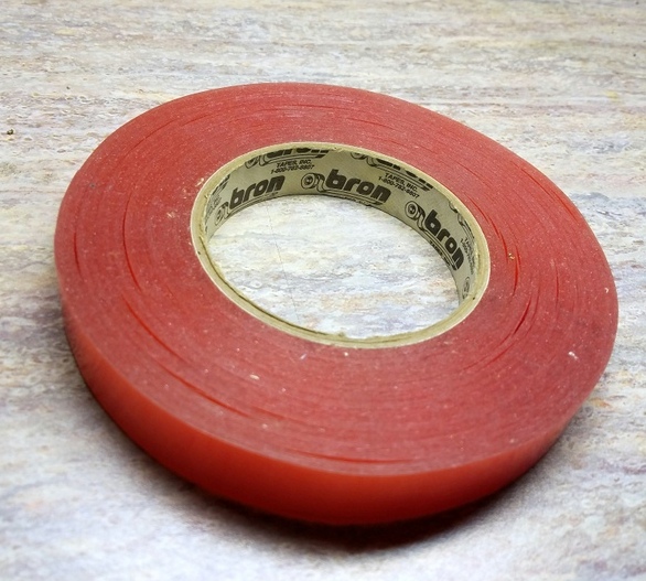

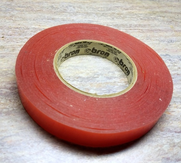

Bron tape from hell! At least that is what the Bron salesman told me. I use it to attach metal pieces to a lathe face plate and adhering things on the mill table. It is very thin.
