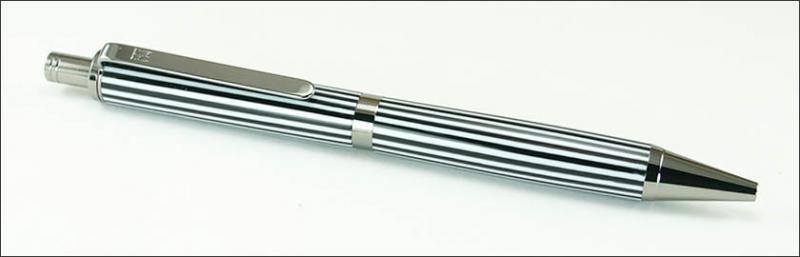

Tried a search but didnt really find anything. I have yet to find a click pen that functions reliably. Ive tried the Polaris and Vertex clicks from PSI and one from CSUSA (the slimmer one with the centerband). Any other suggestions? Folks ask for click pens pretty often so I'd like to find at least one I can add to the lineup.

I use the sierra click, elegant sierra click, and full size guardian. They have a rough time of it with me. They've all been dropped on concrete and asphalt numerous times, and I've yet to have an issue with the mechanisms. The only one I've had to retire (elegant click) was just beat up so bad I didn't want anyone to see it. It still worked great, though.
Believe it or not, I like these from PSI
