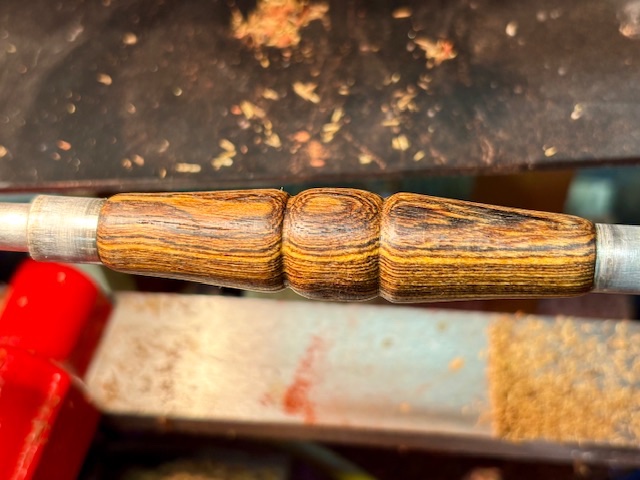

Back again. Still trying to figure out what will work best for me. The carbide tools were amazingly easy to adapt to - very sharp and easy to control. A good friend of mine swears by them. But I'm also still working on using the HSS tools, which are proving to be a bigger challenge. I'm watching every video I can find on HSS tool technique, particularly the spindle roughing gouge, which seems to be the preferred tool among most youtubers for rough turning. So at this point, I'm doing a lot of back-and-forth between tools.
For my next batch of bocote measuring cup handles, I'm thinking of going back to the HSS set. The first four I turned with the carbides came out pretty well (example shown below), but I think I can get cleaner grooves with the skew. It was a real struggle keeping these grooves clean. Or I may stick with the carbide tools for now just for consistency, and experiment more with HSS's on the next project. Sorry for the rambling - this is my brain scrambling itself.
To further complicate the decision making process, I just ordered a Bucktool 8" dual speed grinder. If I'm going to compare tools, it makes sense to give HSS a fair shot against carbide by keeping them as sharp as possible. I see these guys on videos turning through blanks like a hot knife through butter; I'm sure a lot of it is technique, but their tools have to be super sharp, too. So there I go. I guess to end this mess of a brain dump, can anyone recommend a good educational type series focusing on spindle gouges?
