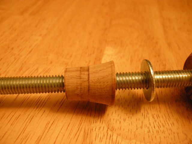

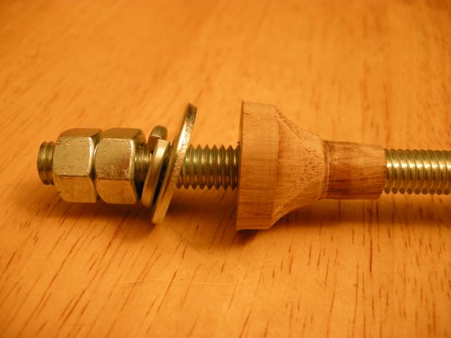

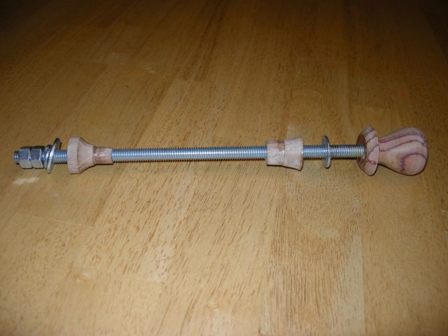

Hi Jim
I had the worse case of the ringing in my ear last weekend:biggrin:, so I came to the IAP to check what's new and I found your thread.
I made my own mandrel for the bottle stoppers using a couple of nuts, washers and some scrap oak. I'll post some pictures and if you have any questions I will be more that happy to answer them if I'm able:biggrin:.
