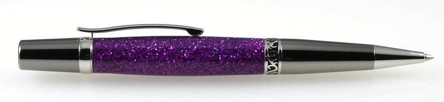

This is a Berea Elegant Beauty Black Ti/Platinum kit with a Glamourz Purple Sierra blank from GlimmerznMore. The Berea EB is a direct fit to the standard Sierra kit. The blank SPARKLES in the light and is a real eye-catcher. They come in pink, gold, green, aqua, red, silver and purple, and are like a normal acrylic blank to turn and finish.
I would think these Glamourz blanks are going to be a hit with the ladies!
Used a skew to turn it down. Then wet sanded 400 and 600 grit cloth-backed 2" sanding disks, wet Micromesh 2400-12,000, Buffing wheel with White Diamond, and finish with Hut Ultra Plastic Polish.
Also picked up a Natural Python Sierra blank to try for my first reptile pen. This site has a variety of blanks I have not found elsewhere.

Nice Pen Bruce.
On the reptile, leave it proud and experiment on your finish a bit before you take it down to final size. The resin on their skinz blanks can be finicky to get a gloss out of.
