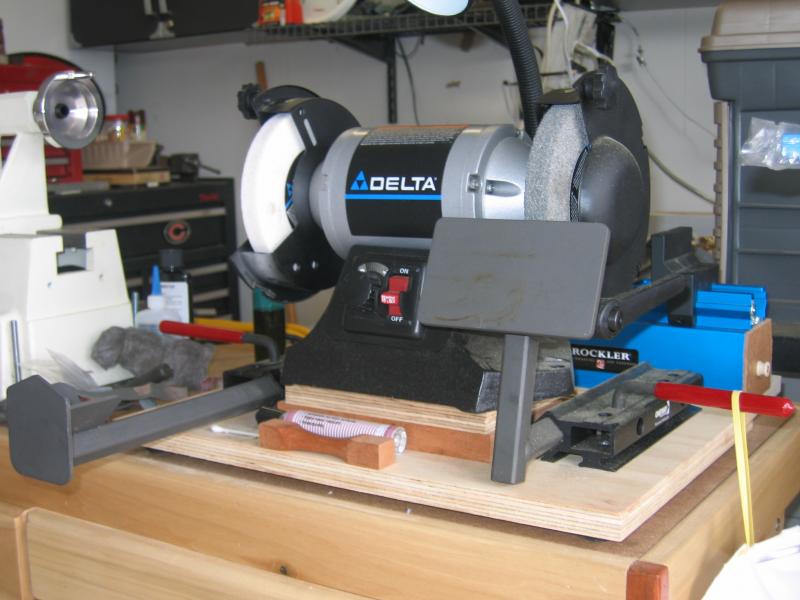

Could you post pictures of how you did the setup.
We simply added an extra piece of plywood under the base of the grinder to raise it up a bit and give the clearance that we needed. I cut it ever so slightly larger than the base, drilled matching holes through it, and bolted it down. Cheap, easy, and worked fine.
Jack
Sorry it took so long, Mate!! Here's the pic. There is an inch and a half of shim between the grinder and the plywood base to slide the Wolverine under. I also put the rubber feet from the grinder on the plywood base so that the whole thing can be moved and clamped elsewhere easily...but I have been keeping it right next to my lathe for quick and easy sharpening timeouts. Hope this helps!!
