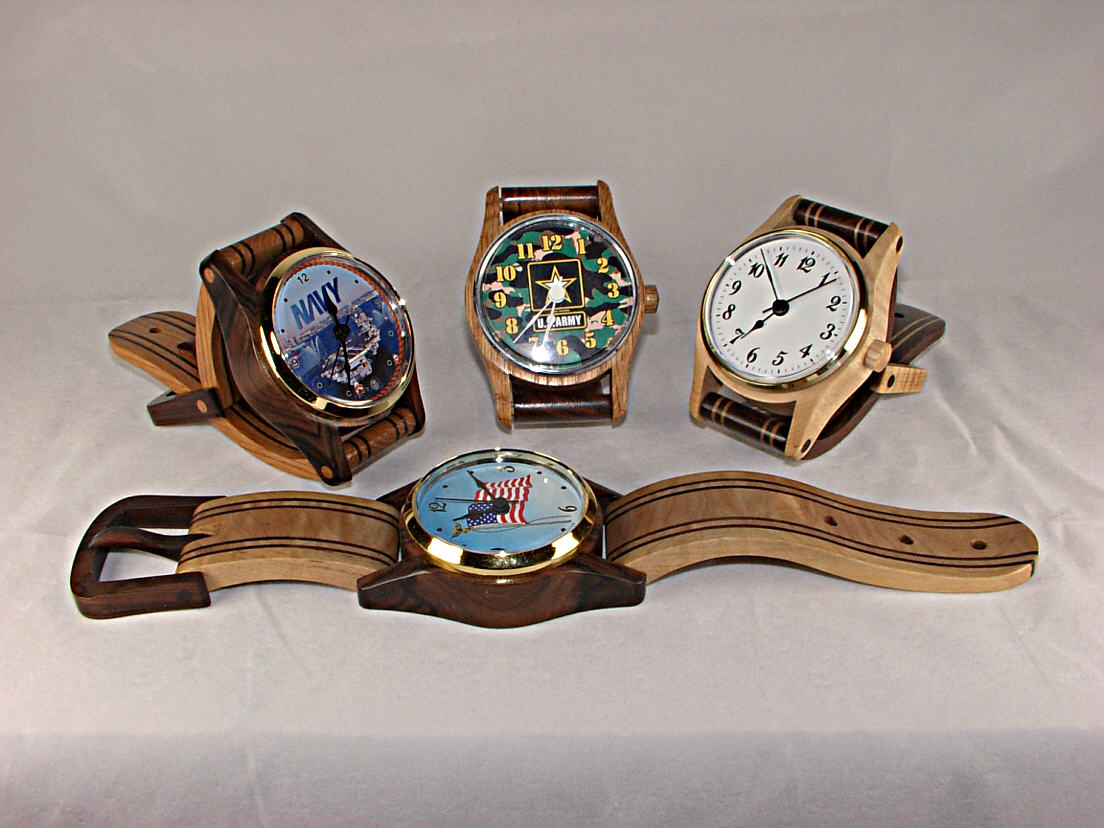

It is a well built tool and as you see a more professional sander. I use my benchtop sander for many things but you ask about the belt. I make many things in my shop and the one thing the belt is great for in my arena is making the bands on my desk watches because I can use the rounded portion as well as the flat area to shape the bands.
Nice JT… real nice.

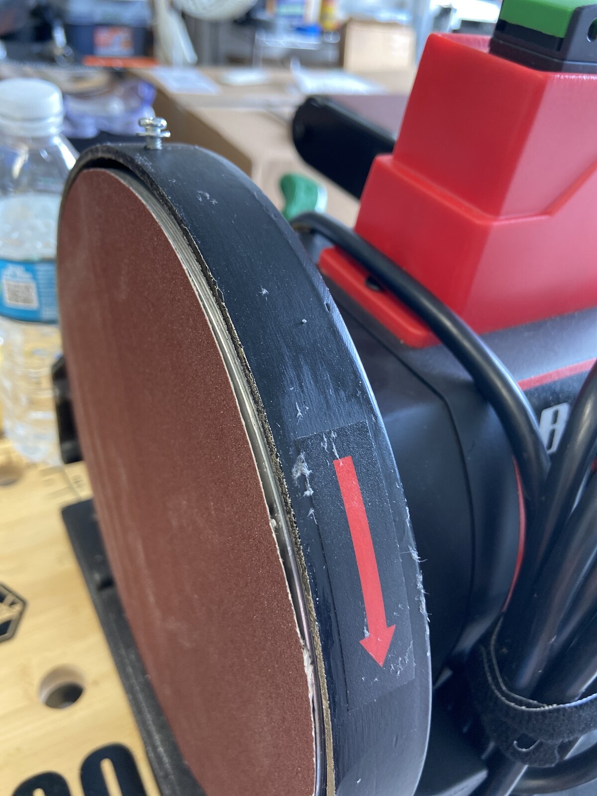

Update on the Buck 8. Mine is the metal not wood grinder. Difference aside from belts …are the platforms.
The disc is Velcro not self stick. Is Velcro ok or is it too cushy to get a well faced blank. I was going to use the 4" belt but shifting toward the disc. How much of a project is getting the Velcro off of the disc.

I removed the Velcro attached to the metal plate. Cleaned it pretty good. The stick on disc is separating. Did I buy cheap junk or is the metal plate not prepped properly.
Edit update. Disc fell off. Not sure if it's a skid row grade disc.
