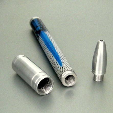

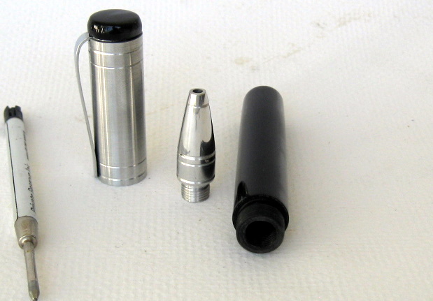

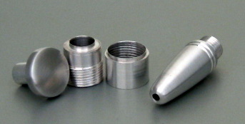

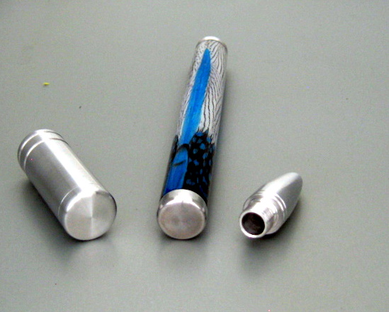

Since you're using a metal lathe, get some taps and dies, turn your own pen parts and, drill and tap your holes. Cut a tenon and thread that part as well. No kits to buy. You can scrounge up some clips if you want them. Here are a few pics of some parts I'm referring to. Beginning with aluminum is a good idea in my opinion. Hope this helps. If you want to use kits, you can. May want to use a drop of glue if you press the parts in.
