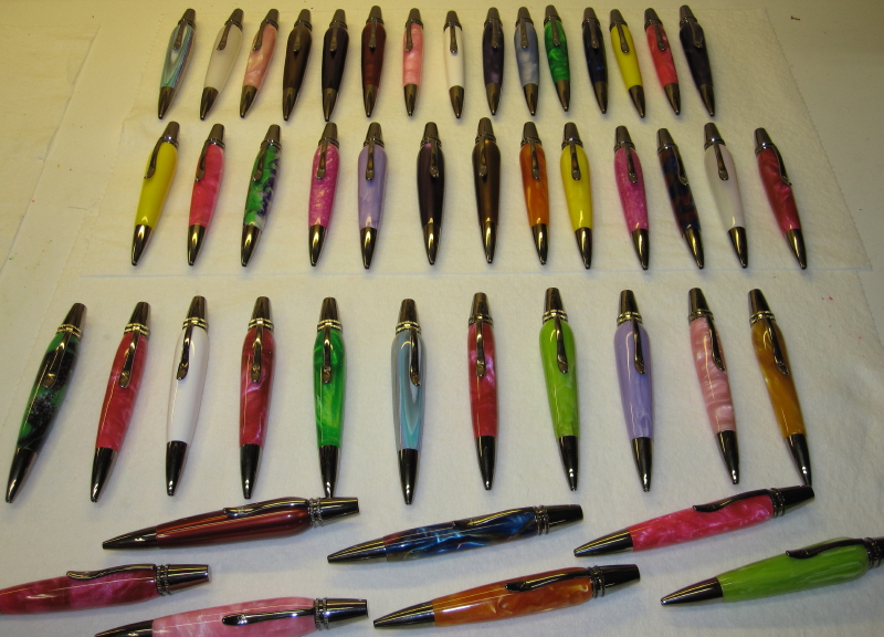

Someone ordered 46 Polaris in black titanium and in various acrylics-he picked the acrylics. He wanted them 'fattys', so I made them in a variety of fatness to give some variety. Thoughts?
Lastly, is anyone else having problem with Polaris pens from PSI? All these came with worthless flimsy springs that allow the refill to rattle around and fall out of the nib slightly. I've had to order bigger springs to complete.
here's a picture
all 46

Those look great. I don't think I have ever seen an order of that magnitude in a polaris before. Great job!
Great job and congratulations on the sale. they sure look good laying there together, finished and ready to ship.

Thanks a lot for the feedback, guys.

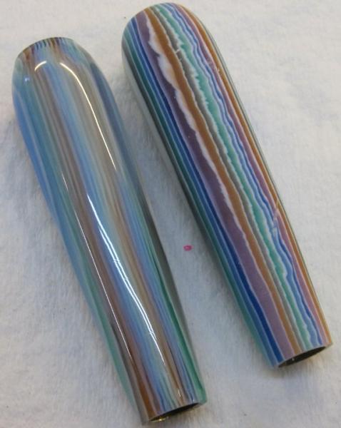

Hope this all helps. By the way, tip: I always finish my acrylics by holding a cotton cloth against the barrel after I've finished polishing, I hold it on until it gets hot and I find this takes the shine one more level.
See photo for the difference.
