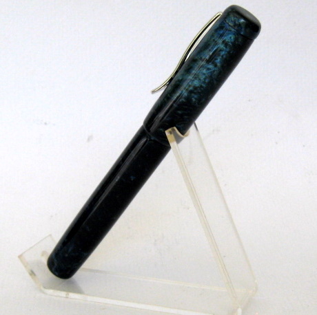

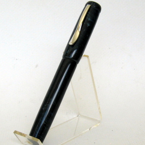

Eric (Buzzzz4) sent me this blank. Blue/Green metalic, changes with light direction, kind of like chameleon colors. It has a clip sent to me by Jon Piper (GoodTurns) Thanks Eric & Jon! Thanks to all for looking!

I like it! What is the nib? Aluminum? and for all you guys making these closed end pens, if they are kitless, where are you getting that little spring that goes in the end of the lower barrel that pushes on the ink refill?
That's really nice looking!
Thank you!
Very nice! Love how it all came together. What is neat about these blanks is that they have a velvet look to them.
THAT'S the word! Velvet :biggrin: Thanks Eric!

I'm going to have to agree with the above - that doesn't look like a 'basic' pen to me. Beautiful work there, and the material is gorgeous. Nicely done!
Ken
Very nice
Thank you!
yea that looks basic......NOT. Super nice pen.
Thanks Chris!
Ken
Thanks Ken, but, compared to yours, it is very much basic:redface:
You nailed the perfect pen for that blank. Flawless.
Thanks Allan!

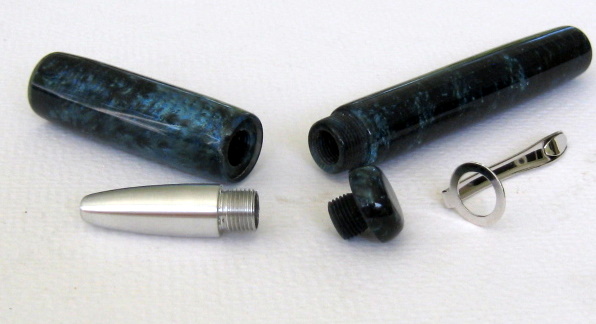

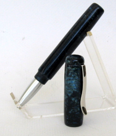

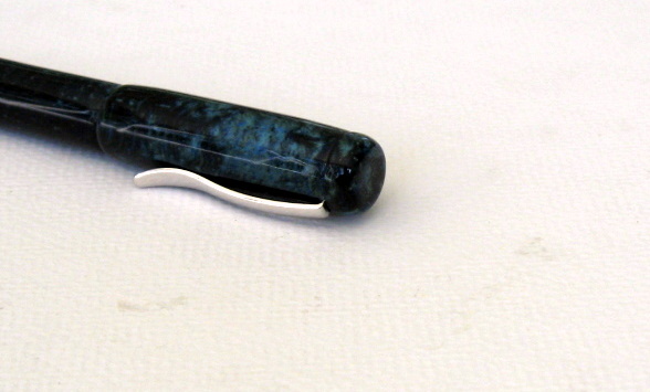

Neat Chuck! How is the finial attached? What does it look like? Does it have an indention? Or is it straight across? Good stuff regardless!
Thank you Hans. I'm adding some photos to answer your questions. I use the mm8x.75 tap & die to attach the finial.

I think you have the basics down, I would think that threading the finial would be overkill as you can just turn it to inside diameter of the tube and glue it in. Be alot simpler I would think(of course I would say this as I dont have nor know how to use a tap and die set) nor do I have a closed end mandrel. but I have an idea for that also. I like it
Thanks for your comments. As for the finial, I have done the glue in on a couple of pens but, I have the tap & die set and, I like to use them. It's kind of like a bonus challenge. Also, can replace the clip if necessary.:rolleyes:
Not to be smart but just for your own edification, there are no tubes in his blanks. And threading the finial is a way of making the pen serviceable.
Yes, it would be easier to just glue it in. But one of the reasons for making a kitless are to push your own abilities trying to make something special. Again, I'm not trying to be smart. I just thought you might be missing the point a bit. I hope this helps.
